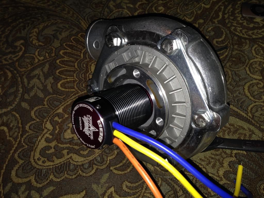

I haven't completely given up on the SeaDoo compressor, but I'm stepping back a bit for now while I rethink and research.
For now I'm going small. I want to see if this can work with a small compressor and 12V dump pack. A bare bones system of sorts. T3 compressor with I think a .50 a/r. I already have a slight damaged one that it can use for bench testing.
The motor I order is a TP Power 4040 3D with a 5mm shaft.
4790kv
Max Amps: 350
Max Volts: 12V
Continuous Power: 1650W
Max Power: 4200W
Garrett impeller wheels actually all have a 1/4" shaft. I think the 7.9mm is probably the journal bearing portion of the shaft.

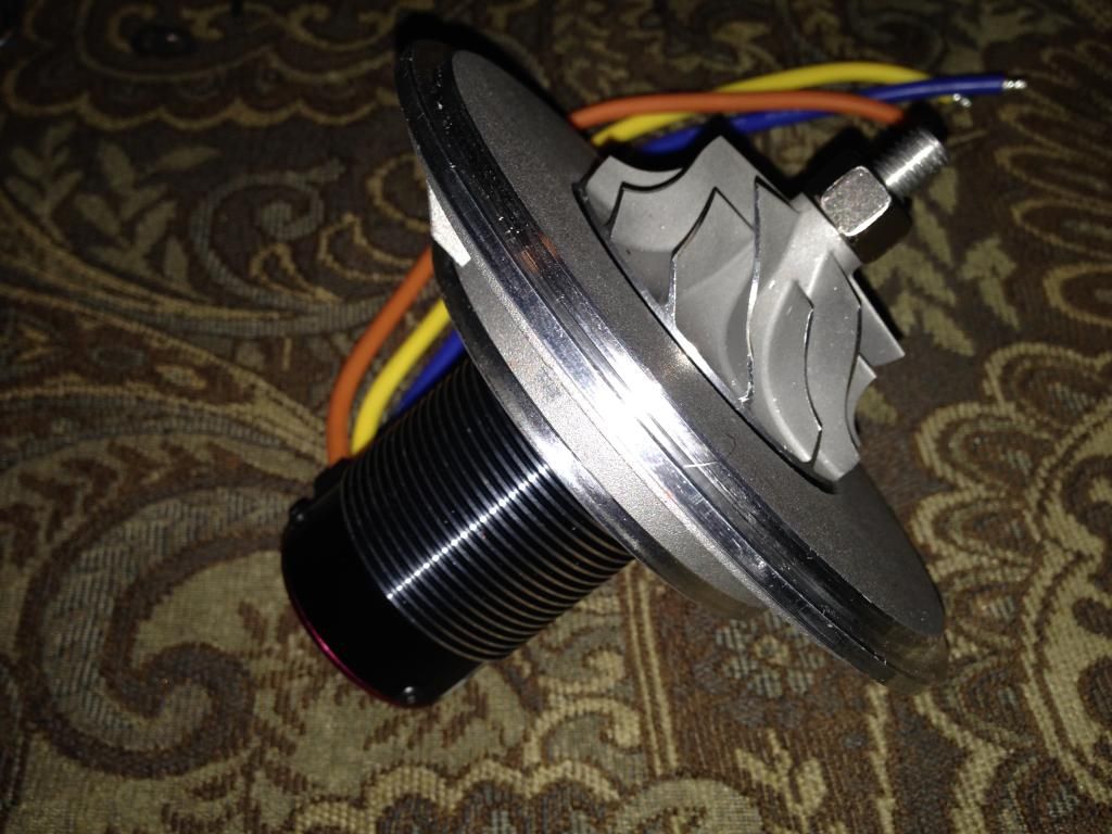

Another update, I got some advice from an RC expert who suggested some changes to my speed controller settings (timing, current sensitivity, break, low voltage cutoff). It worked, and I'm getting much better control of the SeaDoo compressor. It's still very finicky though and doesn't like fast starts/changes, and cuts off before reaching full throttle.

It's really hard to say. The motor I'm testing first is capable of 4200W peek power so that would potentially put it on par with he Phantom Electric Supercharger, but I'm really not expecting it to work as well.
I'm planing in getting into the shop sometime this week to do the machining on the compressor. I've already assembled and installed the 12V power system in the car. In theory the motor I ordered should get her sometime this week or early next week.
Even with very low boost I'm excited to see what a 12V system can do.

Sorry I haven't given any updates recently. A combination of waiting for parts and just taking a break lead to not much progress. Today however I made it to the shop and finished the machining on my small 12V compressor. Everything fits perfect and it's a solid setup.
I don't expect to get very much boost out of it at all. In fact if I can maintain positive pressure at redline I'll be happy. I'm using a sensored motor to help prevent cogging issues I've had with previous setups, and it should provide much smoother operation.
Next step will be lots of bench testing and building a control system.
