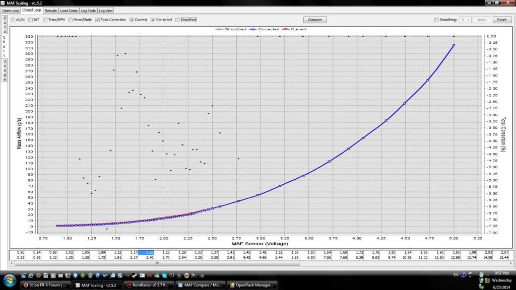

heres what i got so far, the corrections % prett much mirror the fuel trims im seeing, makes sense to me i guess.
The fuel trims at idle tend to vary a bit as thats where the iat can climb when your stuck in traffic, its also where you get the most variation in iat especially on a hot day and you have been going hard.
looks fine to me
the ltft is usualy -3 to -5% now, and ive noticed what you mean about the IAT affecting it, right around 90 i start to see the changes it seems. while cruising with steady throttle the fuel trims rarely go over 2-3% in either direction. so ill maybe do another round of scaling on closed loop after i put some miles on, then start on the open loop. during open loop fueling i never see above 3-4% so i would say its not realy necessary, but its fun learning how to do this. this program is pretty nifty and this is a great thread. i started yesterday with aboslutely no idea what i was doing, and after reading everything and everyones help, i feel i got a solid basic understanding of this. im constantly amazed at the amount of help and expertise you find on the internet.
You don't have to wait as the tool uses both LTFT and STFT. What I would say is that set the maximum IAT filter to keep your temperatures within a decent range. Once you have a good scale, don't worry about constantly chasing 0% error as it will change day to day. The next area to check is the OL to CL transition. Using the spreadsheet tool as a checker/smoothing can be useful. I've also started checking non-WOT OL scaling which made a big improvement on my car. Not sure if it will be as big a change for NA but I'll throw up a how to anyway.
