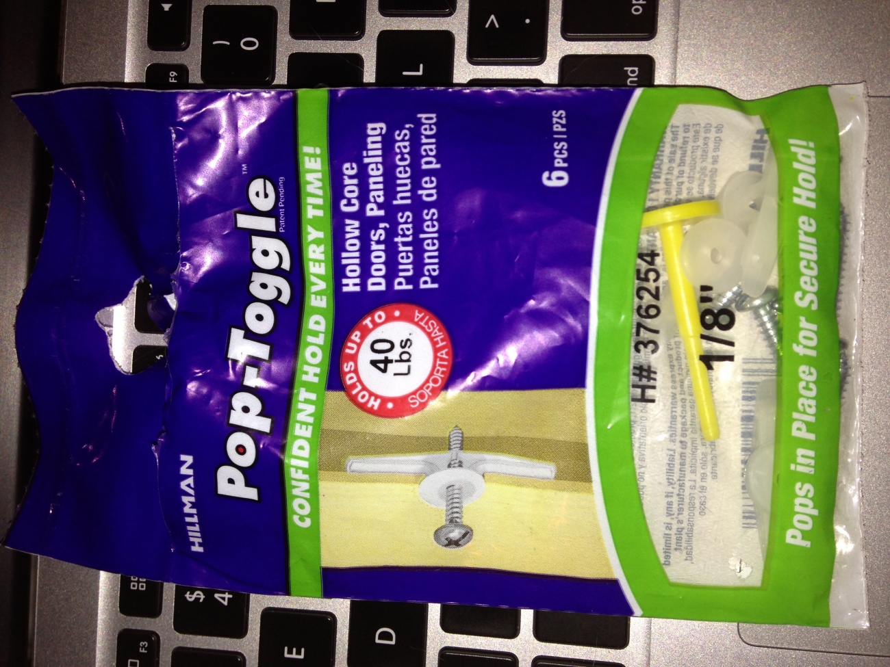

Originally Posted by tg_1981 View Post
I pushed in a few as well. I went to home depot and bought this Attachment 34780 worked out well and feels even stronger with these in. I only used the anchors and was able to use the screws that came with the armrest.
Installed mine this weekend. Thank God you posted this because I was so pissed when 3 of those little stopper things went through the hole. So I just replaced all the rubber things with these Pop Toggles and then it was easy to finish.
Other than that, the install was pretty straight forward with the template and everyone's tips/instructions. I tried to take my time because I felt so bad drilling into my car haha. I just wanted to make sure not to screw it up. I don't like doing any mods that require drilling.
