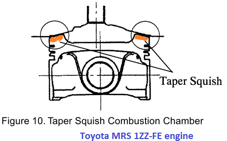

Well as far as squish zones go, below are squish zones on some well-known port injected engines from tdifferent angles. Here's the taper squish zones on a 1ZZ engine:

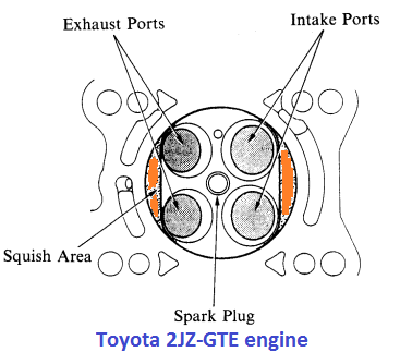

Here are squish zones on a 2JZ:

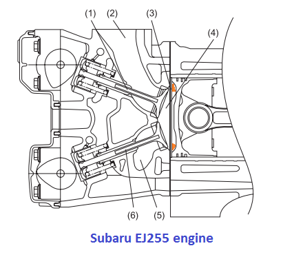

Here are squish zones on a Subaru EJ255 boxer engine:

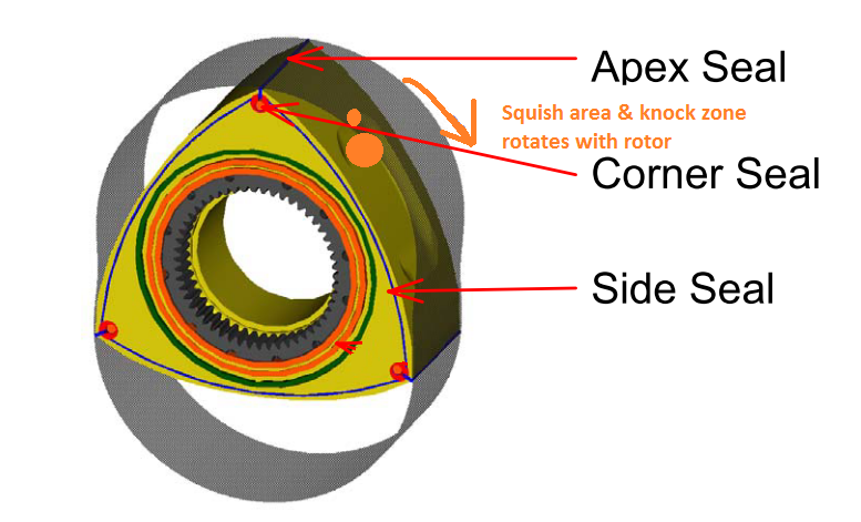

and here is the squish zone (which is very knock prone) on a wankel rotary engine:
If you have a different combustion chamber shape (wedge for example, on a GM pushrod V8) then the squish flows will be different. I don't know too many specific details about squish flows on GDI engines.

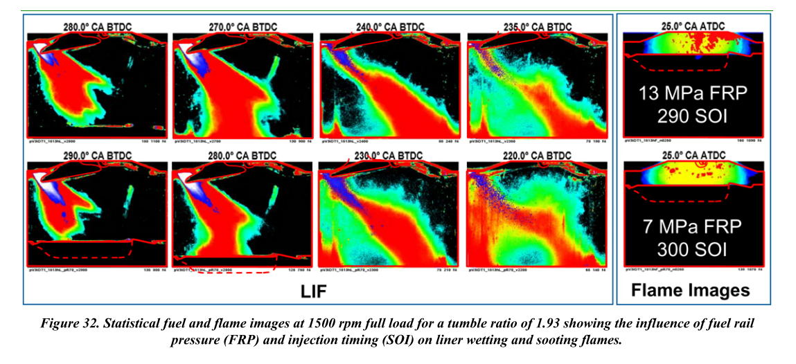

The spray does induce additional kinetic energy into the system. Expensive computer models and optical engines (transparent single-cylinder with high speed photography) are used to study these effects. Maybe I've posted something like this before, but here are some visualizations of spray patterns based on fuel pressure and start of injection timing on a prototype flex fuel Ecoboost engine.
