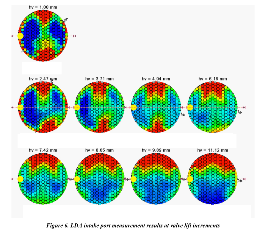

Tumble can also be represented through computational fluid dynamics visualizations. Below are flow visualization diagrams for an experimental E85-capable Ford Ecoboost engine. Imagine you are looking down into the combustion chamber from right above it. Red areas indicate flow that is moving towards the piston, and blue areas indicate flow moving towards the head. The chart is for an intake port with a tumble ratio of 1.89. Each image shows the flow fields at different valve lifts.
If you read about the development of the production Ecoboost 3.5 engine as well as the Nissan direct injected engiens (Juke MR16DDT and M56 VK56VD engines) there is a lot of talk about the shape of the edge of the intake port. The curvature and aspect ratios there have a big effect on these flow dynamics, which then affect mixture formation and combustion efficiency.
