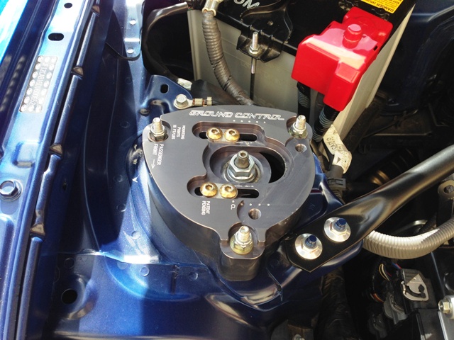

Originally Posted by xDanger_208x View Post
Any installed pictures?
I'm running Ground Control camber plates. Gained about 0.5 inch travel, gained 0.5 degree caster, with tons of camber adjustment left
