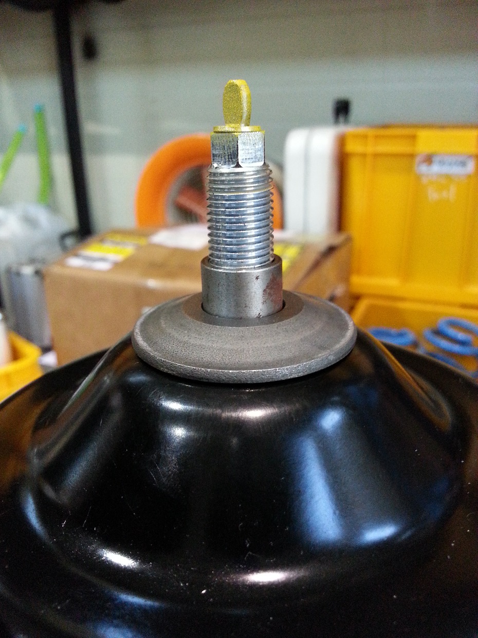

This is a stock spring perch on the Koni Yellow.

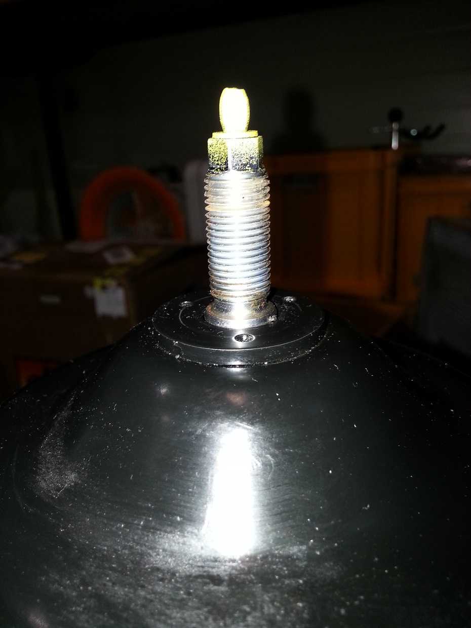

And a spring perch without flat washer on the Koni.

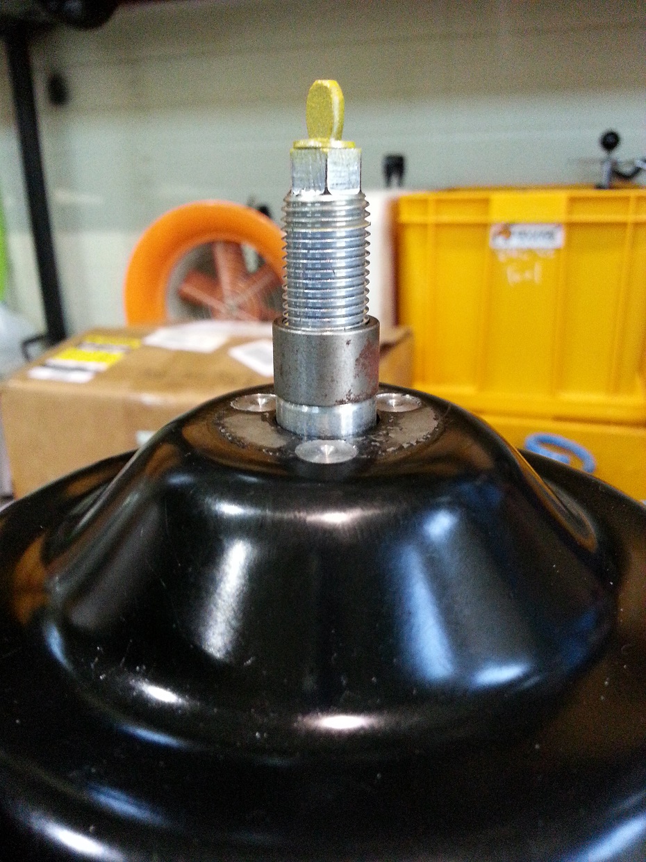

With a conical washer. As you can see, the conical washer is slightly thicker than the flat welded washer.

I've installed Com-C mounts with RCE Tarmac springs and Koni Yellows.
Attachment 79873
Attachment 79872
Attachment 79873

Originally Posted by Calum View Post
So drilling was the best way to get the flat washers off. Did you try any other method?
A conventional drill bit didnot work.
A spot weld cutter was used and the result was great.
I don't know exact size of it. You may guess from the photos in my previous post.

I got small pop noise sometimes when mount nuts are not tightened.
Koni Yellows have not enough threads left with conical washers. The urethane(or whatever) stopper at the top part of the mount nut cannot contact with the shaft of Koni. So those nuts sometimes are loose.
Except that problem, currently working well.
