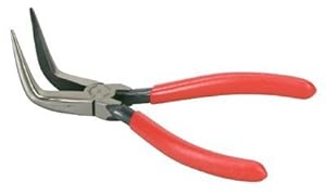

I'm sorry to say, but that is going to be a PITA. Why in the hell would they do that?
You might need one of these
But for reference, I did it with channel locks. To find out what worked, I pushed away and pulled the spring/perch towards me, as well as wiggled it sideways to try and get it loose.
