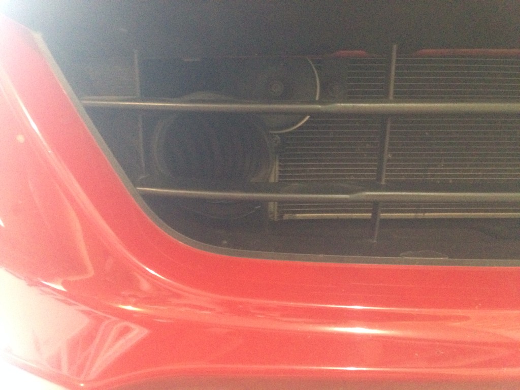

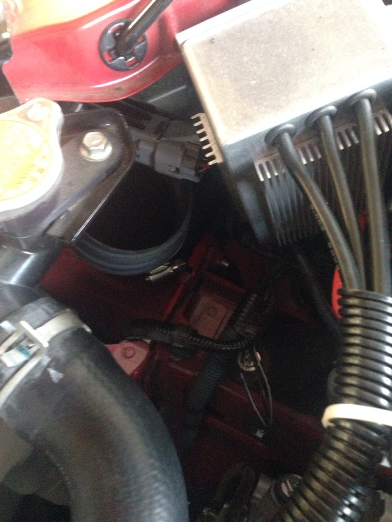

@fenton did the mod:
Front:
Inside engine bay:
This is a quick mod. Not the full one I plan on doing. Going to test now.

Good news: I got more pulls in and also noticed that as long as I was moving the system never engaged the thermal sensor.
Bad news: after 5-6 pulls on the freeway and after two really aggressive long pulls on the street... When I came to a stop the thermal sensor kicked on.
Will run more tests but I think it's helping.
26.x thermal trip is there to reduce charge voltage to prevent gassing.
The dump pack will be in it's HCA range so boost will be only slightly less @ a lower charge V (log boost when you hit 26.x) .... continue to push the system until boost is shut down. 26.x does not mean the fun is over
The duct looks promising!

What does gassing mean? As in to make sure the batteries don't overheat?
i think when I run the scoop up front it will help significantly. I really want to thank @nlowell for telling me about this and helping me get this moving forward. Also when I met up with Jeff today, he told me about making the side vents into functional vents. After reading about it I think this is something else we should look into. I'll let you know when I see anything that is inexpensive and functional.
