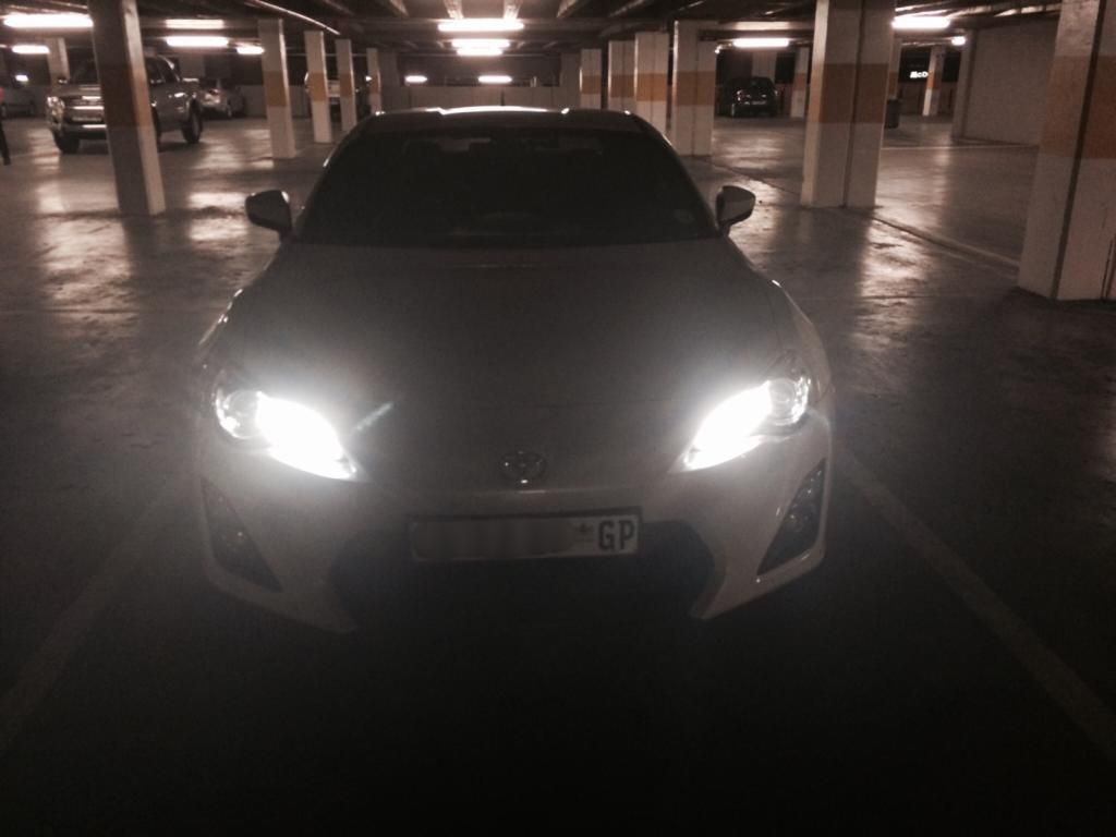

Before
After

Wow The DRLs on bright are SERIOUSLY bright. Looks great though!

Thanks yeah, they'd be blinding at night.
Took almost 2 years to get them working. Never give up. Thanks for the help @GeeTee86 and Anban.
