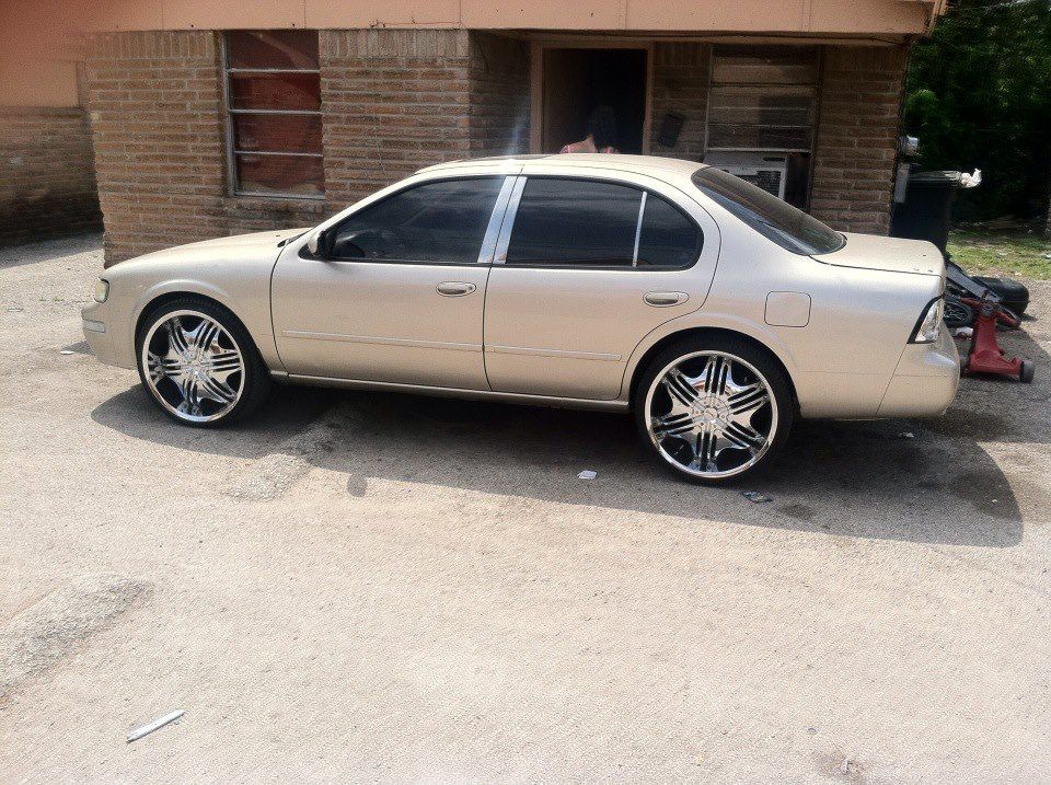

You should honestly be fine with maybe some springs and 18 inch wheels with maybe 225/40. I'm lowered on coilovers with filled wells and have no problems with speedbumps. There is a whole bunch of clearance.
If you went with 19 or 20 inch rims WITH larger tires I think you'll look like this lol:
Thanks, You're probably right! I just checked out your build, nice job. Those rims/tires are the sort of look I'm going for. Your car sits VERY nice
