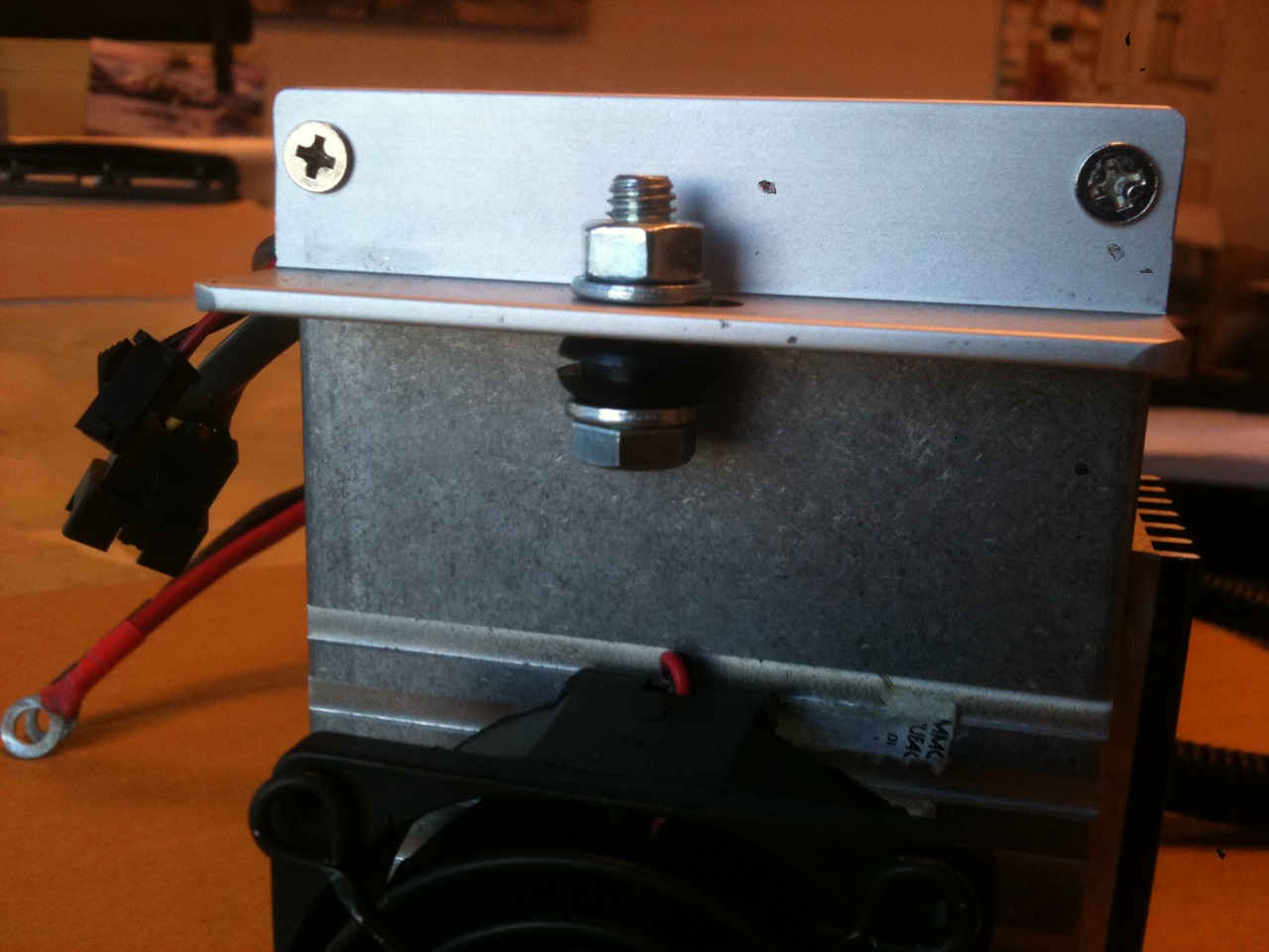

Originally Posted by TM View Post
I got the Phantom ESC today and installed it after work. The ESC was staring at me all day!
It was so tight against the fuse box that I had difficulty reaching underneath to put on the nut.
TM, The bolt to retain the controller goes the other way, not a big deal, but it is easier. It is oriented as delivered (see pic), the grommet fits in the punched hole on the front beam location. The bolt then goes through from underneath and is held by the grommet, so it looks like a stud, the controller is then installed/washer/nut...as you tighten the nut the grommet will prevent the bolt from turning (hand tight). I may add this detail to the install.
Fresh batteries have a 'storage' charge...they need several cycles to complete the manufacturing process.
Thanks!
Rob.Name:  bolt.JPG
Thanks!
Rob.Attachment 76755
Oh haha, that makes much more sense. I just assumed it was upside down. I'll fix it when I clean up my engine bay.
