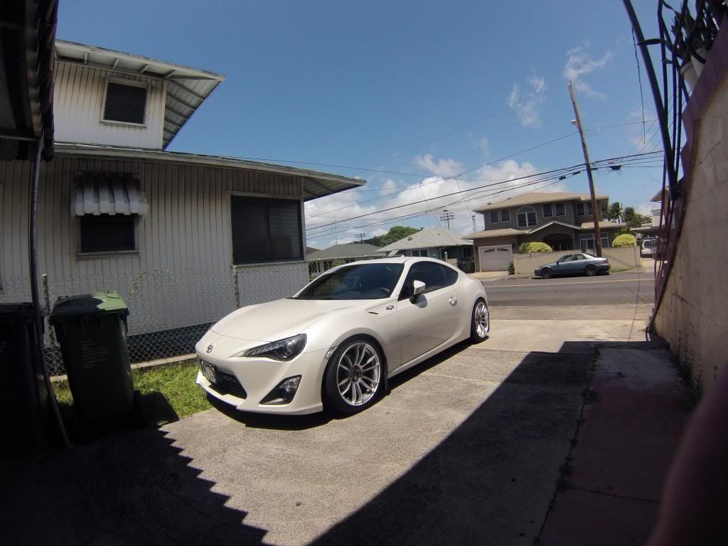

My Sunlight Silver Set.

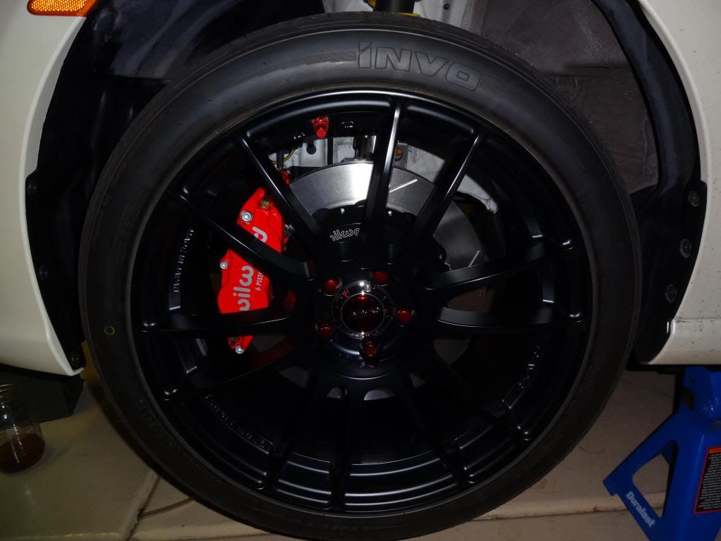

Originally Posted by Supermassive View Post
Well I have the 18x8.5" front's and Wilwoods and I can say that for a fact the 18x9.5s will fit for sure. There is so much clearance for the calipers that it's actually kinda ridiculous. I'd say the closest the wheel comes to the caliper is about an inch...I don't have any great pics to prove it, but here's a pic showing the front's mounted up.
so if you havethat much clearance would a + 47 on a 8.5" wide wheel still clear you think?

Originally Posted by Pablitomarrero View Post
Yo hey! More pictures of this please! They look great!!!!
Will do, once the weather clears up been raining a whole week straight! Thanks!
Originally Posted by FullTuneZN6 View Post
9.5s square or 8.5s up front staggered?
18x9.5 +40 all around. Square.

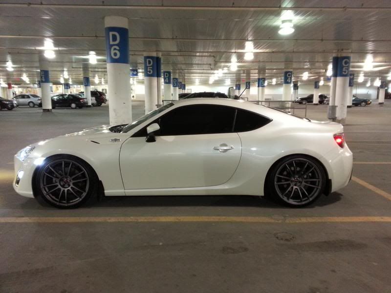

19x8.5 +33/19x9.5 +43
225/35/19 and 255/30/19
