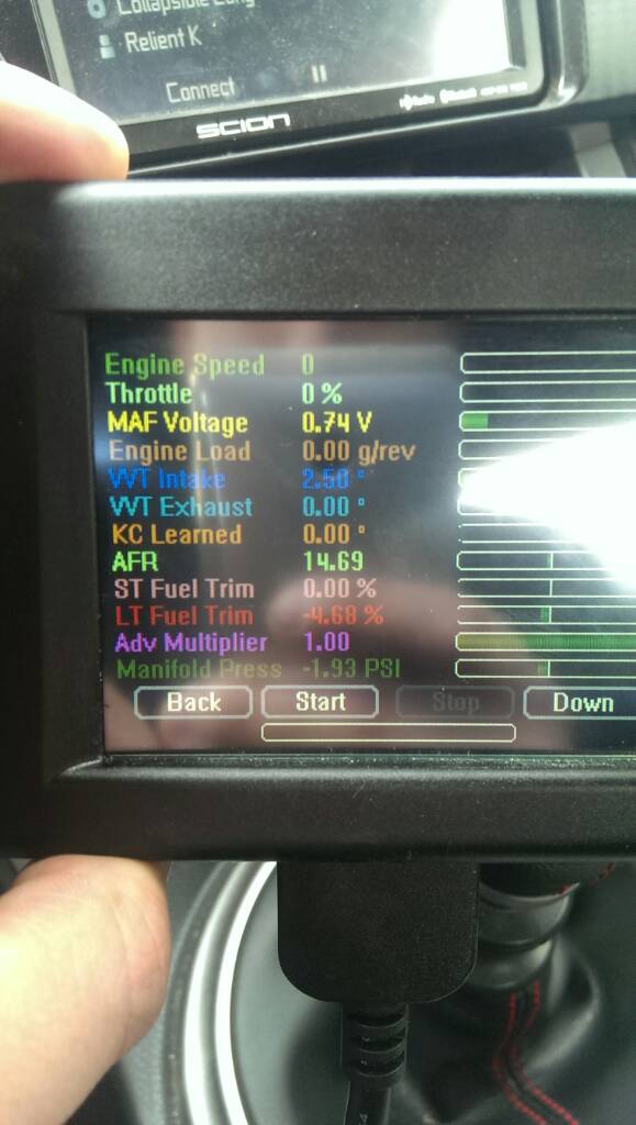

Hey guys. If you are watching manifold pressure on the oft you have to add the atmospheric pressure to get your true boost. With my car off the oft reads -1.93 boost so I have to add 1.93 to get the actual boost being created Name:  uploadfromtaptalk1397240127166.jpg

Hey guys. If you are watching manifold pressure on the oft you have to add the atmospheric pressure to get your true boost. With my car off the oft reads -1.93 boost so I have to add 1.93 to get the actual boost being created Attachment 74169
Sent from my HTC One using Tapatalk
This is correct.
Here in the SF bay, my atmospheric pressure is 0.24psi

So is there a way to monitor the corrected value or just have to monitor absolute manifold pressure and subtract?
