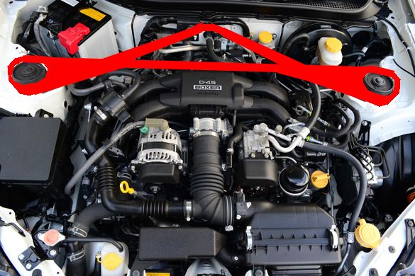

Just for reference, this strut bar was a compromise for me. Its not the best one out there, nor is it my ideal solution. I couldn't justify spending huge amount of money on one, nor could I find one I like I really wanted.
I also would normally state buy a quality suspension first, but even the stock struts/springs are extremely well sorted on this car, I don't plan on making the move to coilovers. Plus the STI tS model comes stock with the STI bar, which tells me something, and one of the first engine bay photos we ever saw under the hood looked like this:
That triangulated super-beefy welded in bar is my IDEAL solution, but not practical and I have no interest in permanently changing the chassis of this car, I plan on keeping it forever in as good of shape as I can.
If I were to design one myself, it would probably look like this:
The lateral bar as far back as possible, triangulated, using ALL the strut tower bolts including the extra ones on each side that the factory supports use, and preferably of a lighter weight. The hotchkis bar is close, but not quite there, and was up there on my list but price and not-using-enough-strut-bolts were downsides for me.
