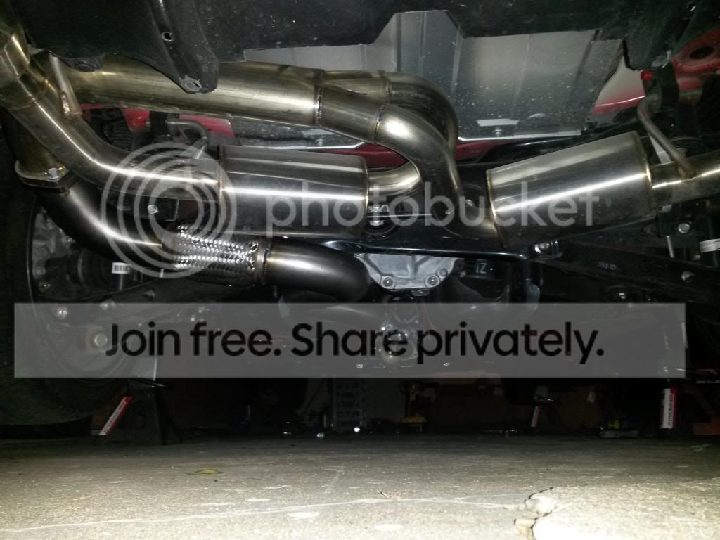

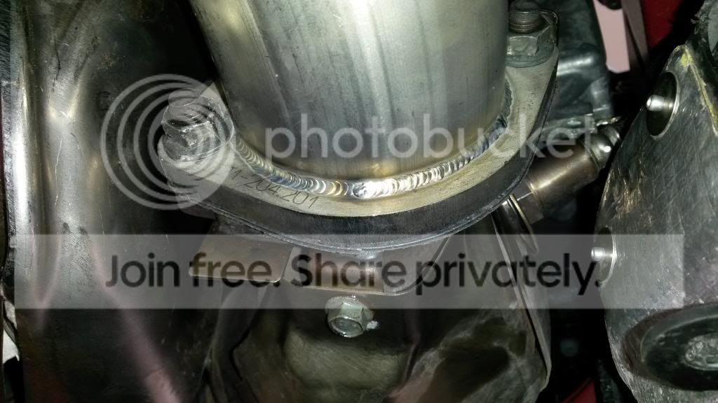

This will be my first post. Ordered my full 3in nameless exhaust(with stock header) back in december and it was worth the wait as far as sound is concerned. Installed last thurs night/ friday morning. Sounds ridiculous(awesome). My setup includes everything you could add on the DP/overpipe combo,midpipe, and 5inch axelback all in 3in. The header bolt closest to the header heat shield is a pain with almost no clearance to properly seat any socket/wrench between the 3inch piping and the nut. Even now i still smell a bit of exhaust. However, that is not what worries me. Whenever accelerating from a stop i hear a banging noise almost as if the engine is knocking coming from the front right of vehicle. I also believe i hear it at other times when already moving and accelerating but i cannot confirm. Whenever installing this was a tight fit especially at DP Mount point and where 5inch muffler touches flex piping on midpipe.

EDIT:
Loosening everything and adjusting it a bit fixed it. When i retightened the bolts to the stock header, i used an axle nut socket to jack up the flange to provide maximum clearance and then tightened it down. Got rid of my jack hammer noise. Thanks all and thank you nameless performance for making something badass.
EDIT #2
After a weekend of autocross and four hours of driving on interstate the exhaust rattles alot again. It seems i have to take the covers off and readjust again. It is rattling at front subframe under accel and at rear subframe all the time. I suspect that the midpipe may be about a half inch too long. It forces the left muffler into the poly exhaust hanger they provided melting it a little, That exhaust tip comes out further than other side. This issue was not there whenever i had just the catback.

You should probably get it back on a lift and loosen it up and start adjusting. When I had my Nameless 3" exhaust, everything fit pretty well the first time around. You definitely need to move the pieces where you want them before tightening.

Your right, i figured that would be what was needed. Guess ill have to park my brz for a bit and rock the ole civic till my friend lets me use his garage again. So many bolts.....[IMG][/IMG]
