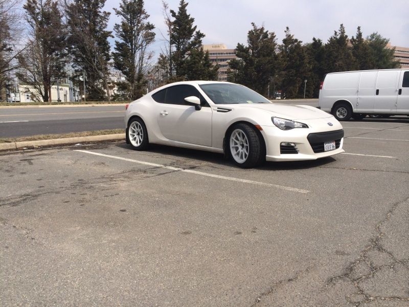

Originally Posted by IAmNotTheDriftKing View Post
I thought 17x9 et42 fit these cars on stock suspension?
Forgot to mention I am also running camber bolts. Hence the clearance issue.
Ah, got yah. I am getting these wheels over the summer, and I also want to run some camber for autox. Spacers and bolts may be in the future for me as well. I could get plates but those are expensive.

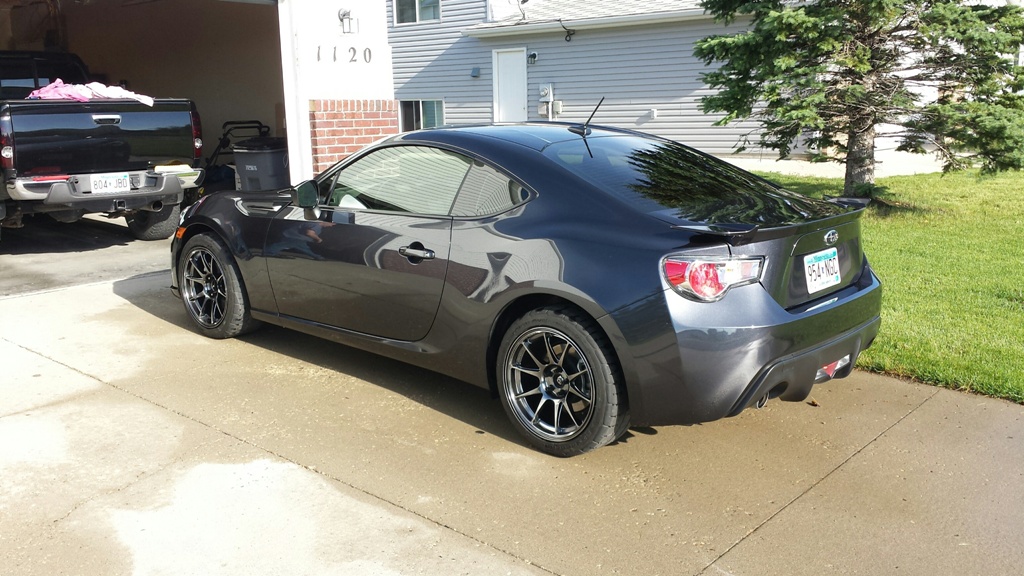

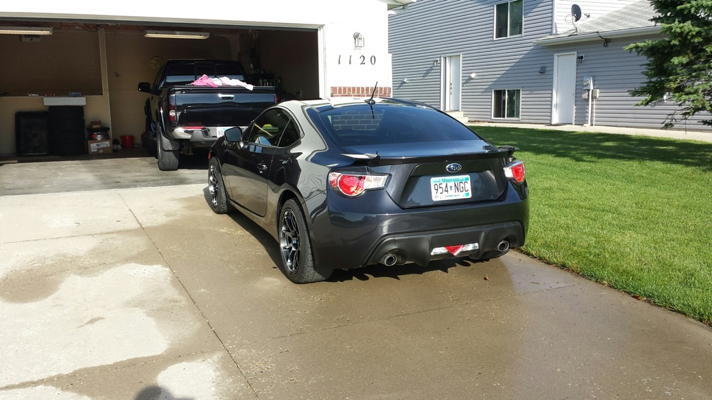

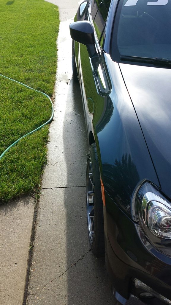

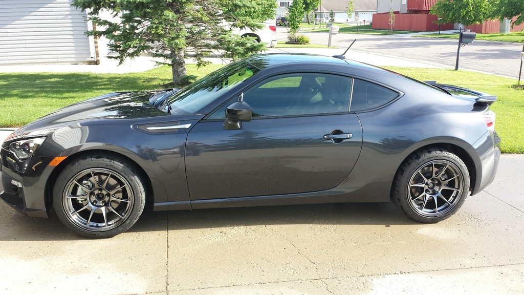

17x9 +42 Rota Titan Hyperblack
-Center Caps do not fit due to hub-centric rings.
245/40/17 BFG Rivals
Stock Suspension/Stock Alignment
No Rubbing/Issues/Ect

Titan 17x9 +42 with Nitto 555 255/40R17 squared, i wish i would have gone with 245 but i got a good offer to pass on the nittos.

Do you think there is enough clearance for a 1inch drop on springs in the future with that set up?
If you get Titans in with a 17x9 +45 offset, you will have a problem like this guy:
http://www.ft86club.com/forums/showthread.php?t=48453
If you do like he did you could do a 3mm spacer to get the offset down to 42. Then again, the titans come in 42 offset already so you'll be fine with the 42 and some 1" lowered springs.
