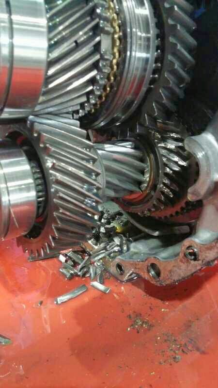

Dog teeth are still there, but none of the teeth on the gear are lol

I got quoted 650$ Canadian to replace just 4th gear and the synchro in my trans and that's with me changing it. You're better off to find a low mileage stocker. Oh and to the guy that said the gears are beefy, heeelllll no they're f@#£ing tiny!!!

That is awesome! But that is the kind failure that you would definitely notice.
It looks like it was all the way in gear so the dog teeth are fully engaged.
The way the teeth are broken it suggests that the main shaft bearing failed first and allowed the two gears to slip apart.
Which gear was that?
