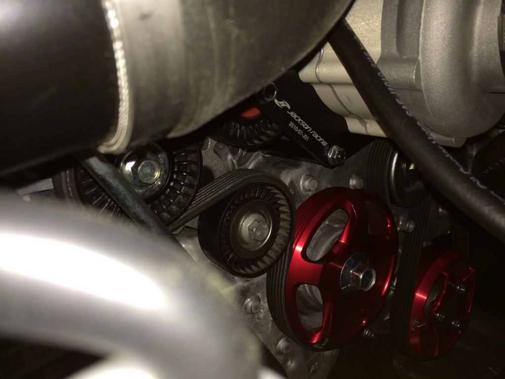

Originally Posted by *LongFella View Post
I didn't have time to bust out the tape measure, but I snapped a few quick photos of the area:
Attachment 70299Attachment 70301
@Calum check it. Thanks *Fella. Some DEI gold tape and $7K would put me in business...
