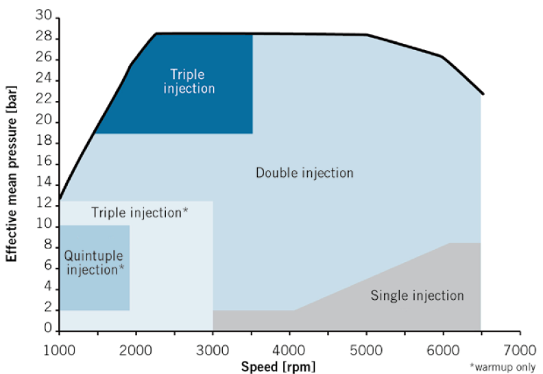

And as a further side note, if the injection system is sophisticated enough there can be multiple injection events for knock relief. The FA20 doesn't seem to do this, but many other DI engines can. Here is among the most sophisticated on the market, the M133 2.0 engine by AMG/Daimler using Piezo A-cone injector:
So you've got different things going on actually inside the cylinder depending whether it's PFI, DI, or PFI + DI due to injection and valve timing.

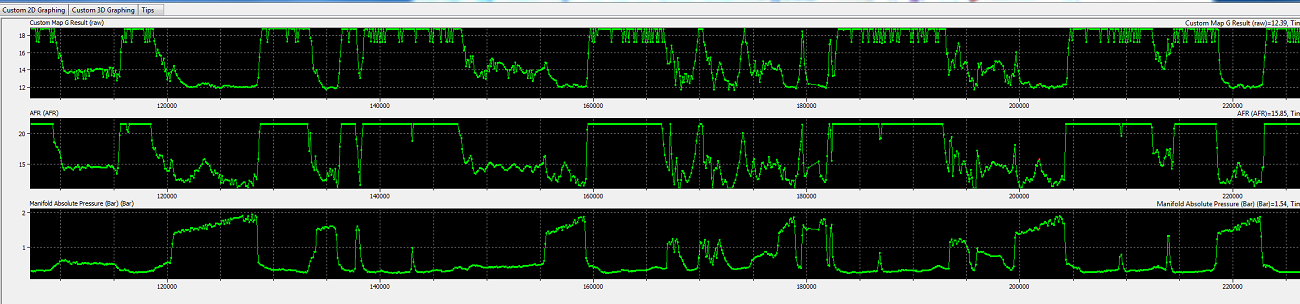

Spent a couple of hours wiring the AEM failsafe WBO2 and using our custom map to log the output (within .2 of what the gauge shows).
Note the huge discrepancy and the inconsistency. The AEM unit shows exactly what our dyno wideband was showing (but .4 points richer as it is pre-cat).
That huge spike that looks to be super lean at 15.8 but it is actually just 12.4...
