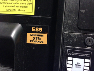

Thanks for the quick response! You probably know more than I do
Pretty sure it's mostly if not all e85. I've been filling up with e85 ever since I switched over. Probably 2 tanks worth.
Although this makes me wonder my e content. This is the closest station by me that has e85
Attachment 68984
http://www.ebay.com/itm/Deluxe-Fuel-...item19e1f4f33e
These aren't very precise because they're lacking fine markings between e20 and e85, but you could always get it to test. Although I don't know how much it'll help since the blend will likely change every time you visit the station. And what will you do if the blend is low in ethanol? Get gas instead? I wouldn't worry about it too much. Just check your logs every time you fill up to make sure something weird isn't happening.
