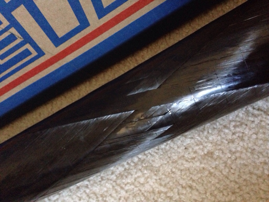

I have a pst driveshaft and can confirm that the weave is not perpendicular. The outer layer is (for the final coating and protection) but the inner weave is done at approximately 45' (couldn't measure). You can subtly see the inner weaves imprint with the eye but not with a camera.

Jason @ DSG Performance told me and here is a pic when i got it, same weaving as the HKS Kansai CF DS which will be available soon, list price is 120,000 Yen like 1200 USD

That looks pretty good. Any idea on how the PST shaft is balanced? I know DSS has the small weight tabs visible on outside but I've never had clarification on how pst shafts are in fact balanced...
