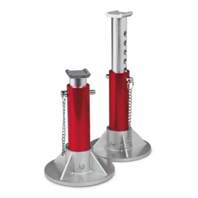

Had the same question...going to get the harborfreight ones + rubber tips.

Originally Posted by Wyattkb View Post
@Bordedom.is.me- You can't really mess up something as simple as a jack stand. The chinese quality doesn't bother me. I have a harbor freight engine hoist that hasn't failed me in 4 years.
I used to work at a HF for a couple years. We used to have people return those jackstands ALL the time when they broke. The white center piece is just cheap pot metal. You have been warned.

My jackstands are like # 2 as well.. nothing for pinch weld. However, mine apparently shipped without the rings/chains negating the ratchet mechanism. So I must take them back.
daaaaangit.

I have been using the harbor freight ones for over a year now with 0 damage. Get them.

If you're really worried, you can also get Esco jack stands. Pricey, but they're padded and distribute the load across a ~5" rubber section, similar to a 4-point lift. Much less likely to damage a pinch weld this way.

I got these from Griots but apparently they don't sell them any more.
Do an Ebay or Amazon search for "Aluminum Jack Stands" and you'll find similar options. TORIN makes a nice set as well.

I stuck an old pair of tennis shoes over the head of the jackstands.
Looks ghetto but worked just fine...

Originally Posted by mav1178 View Post
Also helps to have this to minimize body damage:
http://www.harborfreight.com/2-piece...and-95952.html
-alex
I use the rubber pads on my jack-stands and they work great.
I wish I could afford those, but the cost of 4 = 2 whole track day fees. Im ballin on a budget here lol.
For now I will just get those poly covers. Although those jack stands look simple enough I am sure I could have my local fabricator build me some for half the price.
Wyattkb is offline   Reply With Quote
I have a set of those.. Rock solid.. But I don't like supporting the pinch weld
With these.. They make pinch weld adapters to support the load and not have the tip of the pinch weld be the support.. The adapter allows the pinch weld to sit in the middle and supported on either side of the pinch weld. Just like the spare jack does..

@Mikem53
I have seen those adapters. But those would only work on a Jack stand like the ones posted correct? They won't sit properly on the C shaped ones.

The problem is when the pinch welds go on the jack, there's where the bending is...

I have 4 hockey pucks (Canadian, eh?) that I sawed 3/4 of the way through. I will try using them on top of my jack stands in the spring. I hope they keep the car stable on the stands as i am super paranoid when underneath.
