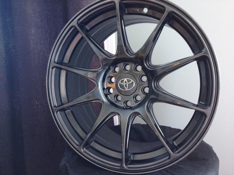

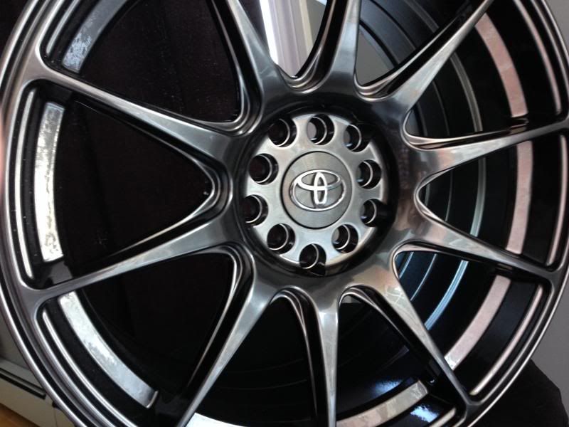

Originally Posted by headlikeahole View Post
The final result.
It was nearly impossible to match the chromium black, if you had gold or black wheels it would be much easier.
Whats the color you used to paint your center caps?
It's part of the DupliColor colormatch line, it's called charcoal grey metallic.
I looked through the auto paint section and compared with a picture on my phone and came up with that one. There might be better matches out there.
