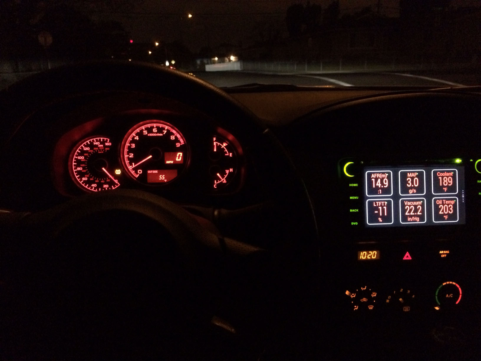

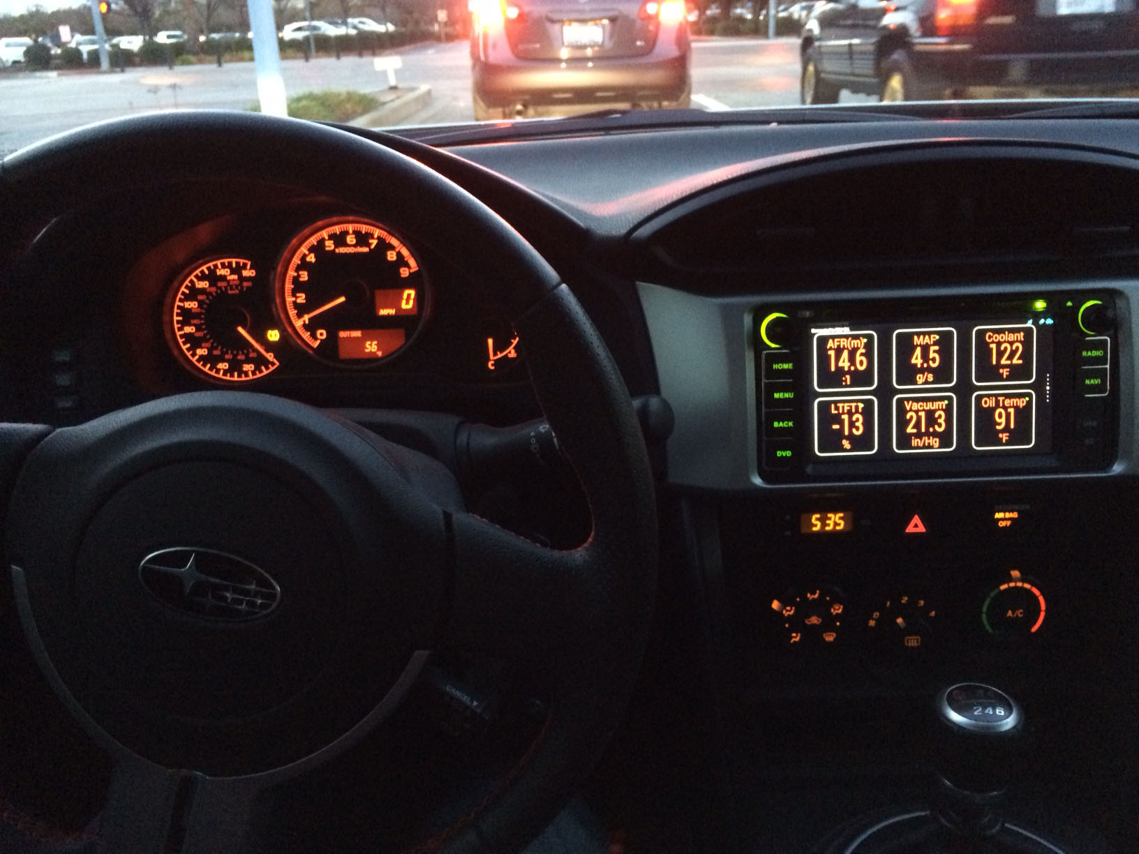

Ok, so I did a bunch of testing with the ScanTool OBDLink SX.... it's better, but not perfect. It's noticeably faster than the generic one I had, but it still pauses once in a while. I've actually never used a bluetooth ELM327, so I'm not sure how it compares. Is this normal?
I think this setup is ok for FYI type of information, but not critical info that changes rapidly. I'll be using it mainly for things like coolant temp, oil temp, etc, so it's fine for me. I'll be using an AEM failsafe for boost and AFR.

And here's how it looks like during the day and night with Torque Pro running:
