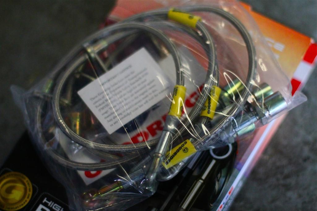

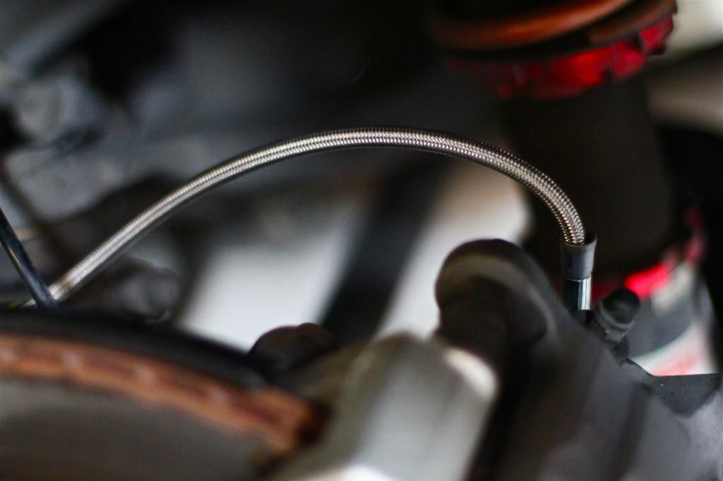

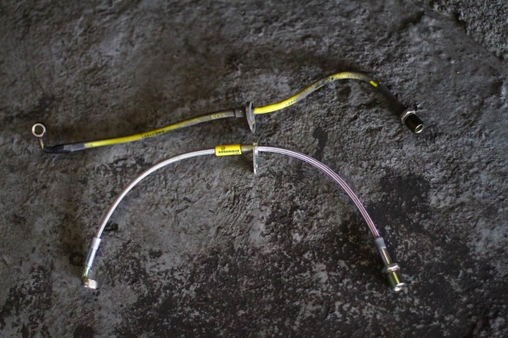

Goodridge SS brake lines and AP Super 600 fluid install (01-17-14)
Goodridge SS brake lines and AP600 fluid install
I had to replace my SS brake lines because the right rear line ruptured during my last track event. Something might have punctured it, or it just burst, I'll never know. I ordered Goodridge US spec lines now, as the Asian Spec Goodridge did not fare so well. The US spec is more robust, and does not have a rubber cover. While I'm at it, I also drained my brake fluid and replaced it with AP Racing Super 600 fluid.
Here's the diff with the US spec and the Asian spec:
Installed:
Pedal feel is still the same, as I was using SS brake lines already. I will see how the fluid fares at the Touge Battle. I'll give a review about it after the event.

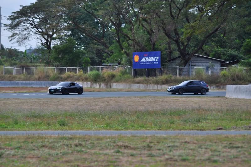

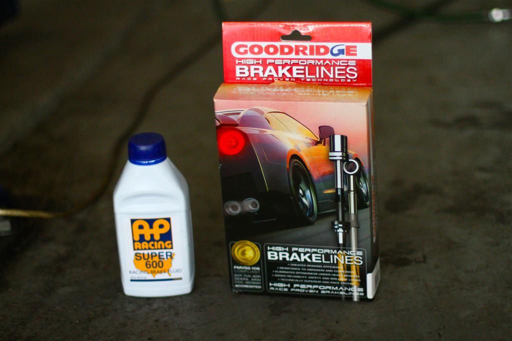

Touge Battle Event, Goodrige SS brakelines, and AP racing super600 brake fluid review
Touge Battle Event, Goodrige SS brakelines, and AP racing super600 brake fluid review (01-18-14)
I decided to enter this event because I wanted to review the Goodridge brakelines and AP Racing brake fluid I put on the car. The guys from Fuel came up with this interesting format based on the Japanese mountain pass races. This time though, we use the race track and they let the first car go with a 5 second delay. You run two times, first as a lead car, and after as the chase car. The winner is determined if you close or widen the gap depending on what position. Brackets are done via time trials, and cars with the closest times are paired together.
Time trial run:
[ame]http://youtu.be/dnrn7xt8VdI[/ame]
Time trials went well, with a new set of tires enabling me to push harder. The brake lines did very well also, giving me a consistent feel the whole day. The AP racing super 600 fluid did great, I went the whole day without any hint of fade. This made me decide to put off getting the big brake kit and use a more aggressive pad instead.
After time trials I was paired with a WRX, and we proceeded to race. We posted consistently similar times and had to resort to run 5 times to determine the winner. It all boiled down to the last run, both of us getting ragged trying to push both cars to the limit. The gaps WRX went faster the last run and relegated me to 2nd place. Nevertheless, I had a blast racing with this format as it is vastly different from time attack because of the added pressure of chasing or being followed, it's the closest thing to grid racing in my opinion.
Here's one of the runs with the WRX:
[ame]http://youtu.be/LYDEIjH95yU[/ame]
I really had a blast doing this event, having the most fun at the track to date.

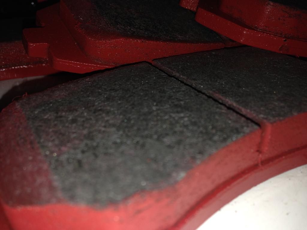

Installed ACRE 900C Brake Pads (01-21-14)
I was supposed to install these pads before the Touge Battle, but they did not arrive on time. I have another track event coming up this week so no biggie. Will get the chance to bed them first on the street before the Toyota Vios Cup this 25th. I've heard great things from Acre, most of my friends are using them, so I decided to try the 900C. A step up from the Dixcel ES pads I had, which was rated to 600C, the Acres are supposed to be rated to 900C. With the great performance of the AP fluid, and the more aggressive compound from the acre pad,(carbon-mettalic, compared to organic from dixcel) I should get better performance. I know it's not a fair comparison, as the Dixcel R should be the equal here, I'm just stepping up from the ES, I'll give a review after the trackday.
Here's a few snaps from my Iphone. Sorry for the low quality pics.
Here's some specs from Acre:
* Formula 900C
* Material: Carbon Graphite Metallic With Titanium & Ceramic
* For Street & Circuit Use
* Applicable Rotor Temperature: 0-900C
* Friction Coefficient: 0.40-0.60u
Tye300 is offline   Reply With Quote
