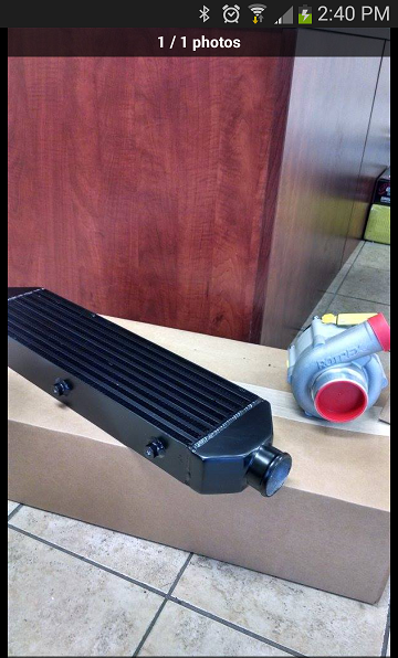

Look what showed up at my installer!!!! Can't wait for next month!!
PRORICAN (01-21-2014)
