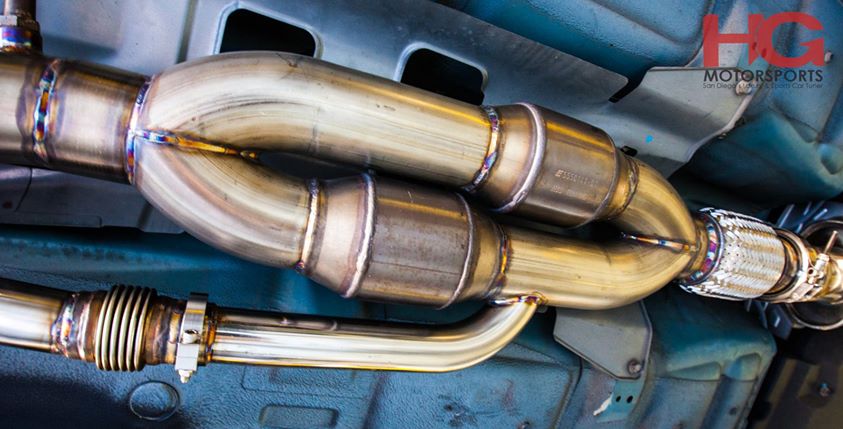

Originally Posted by CSG Mike View Post
That would depend on the actual diameter of the cats...
I've seen cats that are 10+ feet wide in diameter in testing cells, and these engines were making 750+ whp. Those cats were a 600 cell too
Completely on point. Here is something we came up with at HG Motorsports for a Subaru STI running a GTX30R rotated turbo kit. He really wanted to stay clean but make power and we found on one high flow 200 cell cat it was just too restrictive, so we put in two. By doing this we were able to add another 50whp and 50wtq.
Also the further the catalytic converter is placed away from heat, the better it will flow. Because as air cools, the molecules slow and can flow a lot easier through small holes.
Cheers,
William Knose
