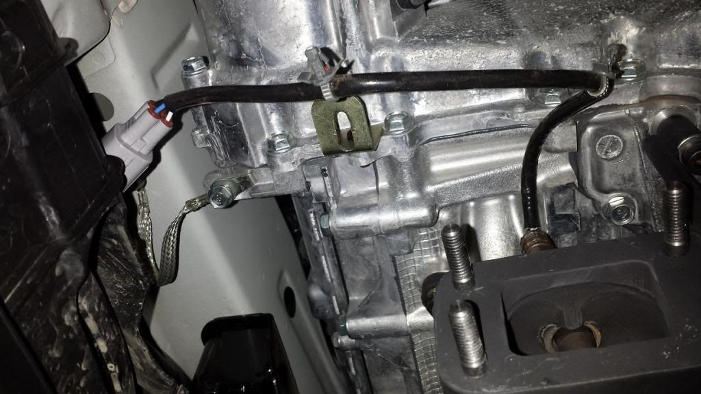

Having a few issues with this kit. The latest is installing the heat shield.
The instructions call for installing a right angle bracket. I found a location with a spare bolt hole that looked the same as the instructions. The problem seems to be that this puts the bracket on a different plane to the bolt that is used for the grounding strap.
result is the heat shield is not flat and the edge touches the turbine housing.
In addition to this is seems that the turbine housing is barely covered by the shield and only covers the head/cam area.
Is this correct to proceed?

That is correct there should be an allen bolt with a small spacer with the kit. There have been a few kits where the spacer is missing. We make a spacer out of a metal tube form the hardware store.
