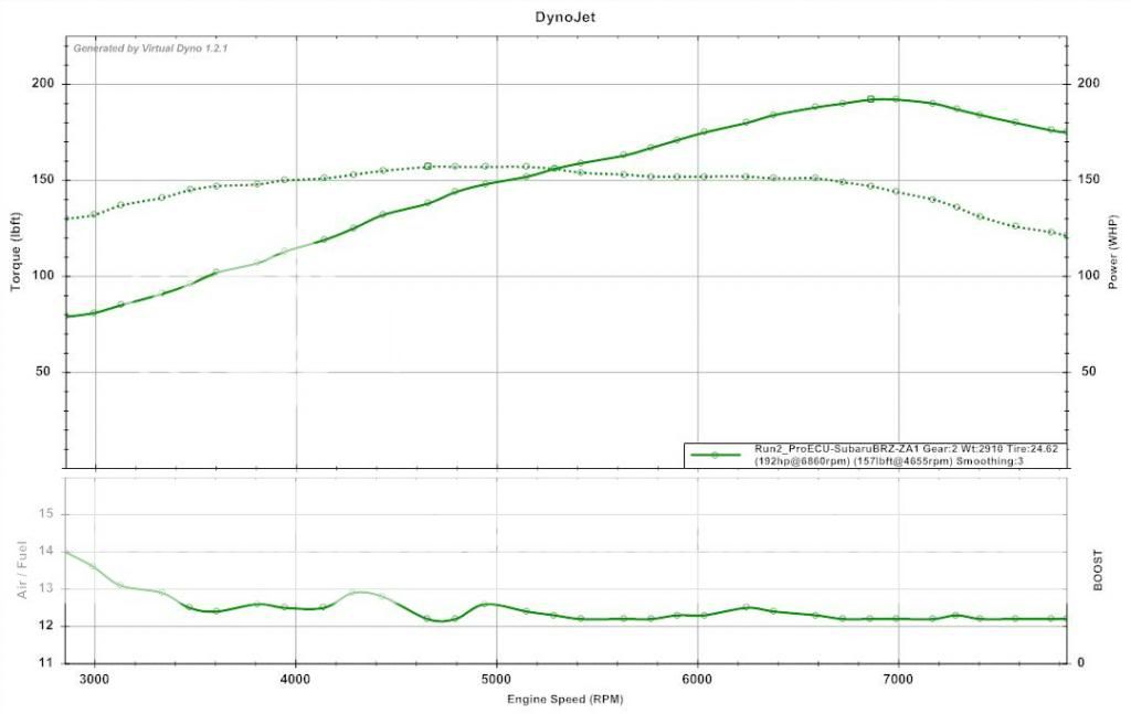

This one has the best (least) TQ Dip so far. This is on Smoothing 3
I forgot to mention these are all tuned by Moto-East.
Simmons
Smoothing on 3 will make almost any torque dip look flat.

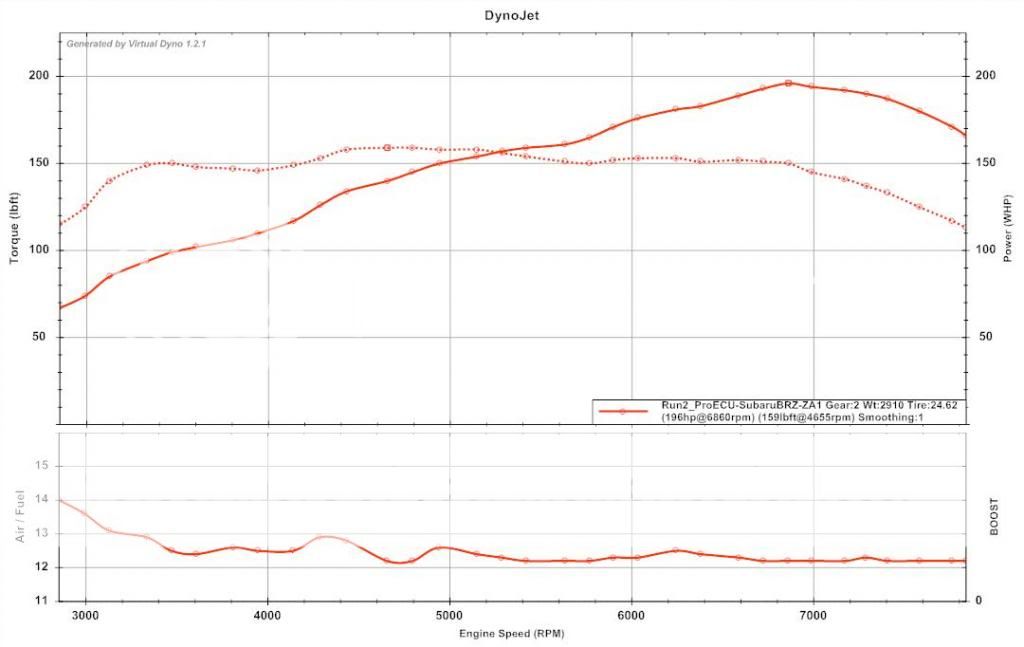

OK, here is on smoothing 1

Cool. I'm curious about how were you datalogging (running inside a VM?)/what gear the run was made in? Trying to figure out why your sample rate seems to be low compared to mine when i select show data points.
Edit: just saw it was a second gear run. Perhaps that's the difference in sample rate.
Yes they are done in 2nd gear. Using Ecutek for logging.

Most of the charts in this thread need more smoothing.
Simmons
Logs should be done in 3rd gear, not 2nd, to use VD properly.
