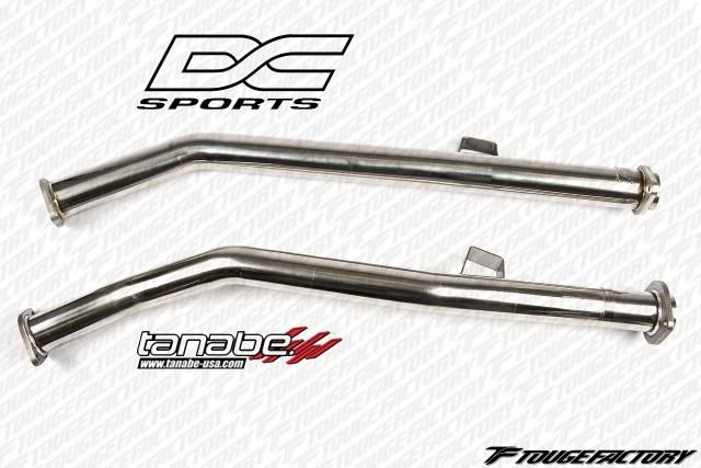

Two budget friendly front pipes we installed. Both fit right on without any issues to our Motiv Overpipe.
both were 2.5" outer diameter. Most front pipes we've installed are all measured outer diameters, and the I.D was approximately 2.37."
You can see that the DCsports lacks the bends.
Another angle
One more to show the bends

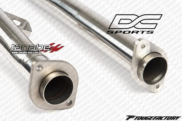

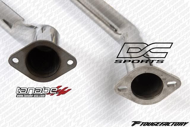

Flange:
Other Flange
Hanger for the front pipe:

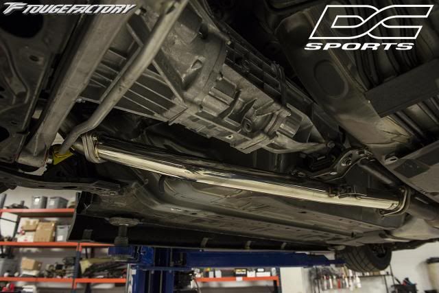

INSTALLED PICS OF DCSPORTS
Without the additional bend by the transmission mount, the piping sits about 8mm away from the transmission mount. Length wise, fitment was better then the Tanabe, where we did not have to pull the catback forward at all to put in the bolts.

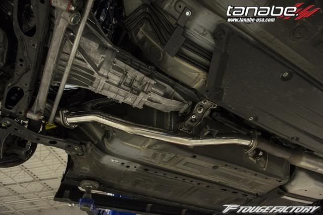

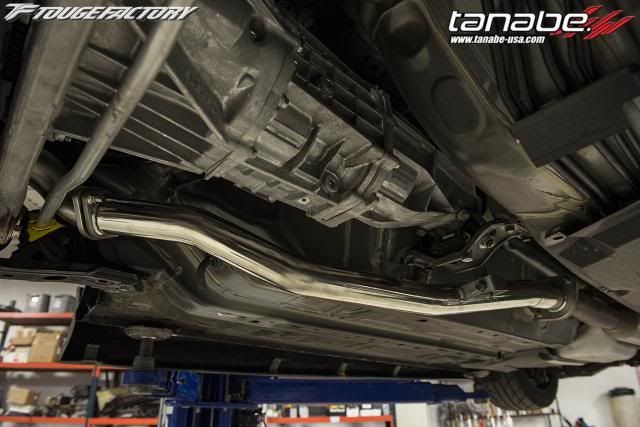

INSTALLED PICS OF TANABE
Tanabe allowed for much more room between pipe and the transmission mount due to additional bends. At least 1" gap between the two.
