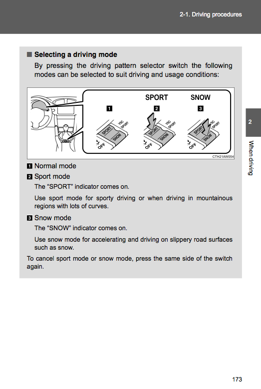

Originally Posted by BRZfan View Post
FYI:
Taken from another thread. Compliments of DESLOCK. Drive Smart, Drive Safe:
"Lastly, for all you AT owners, from page 173 of the owners manual: "Use snow mode for accelerating and driving on slippery road surfaces such as snow."
,http://www.ft86club.com/forums/attac...1&d=1386759431
I use snow mode in my automatic equipped Jaguar. Works as advertised. Or you can manually start off in second gear which is primarily what snow mode does for you.
Suberman is offline   Reply With Quote
