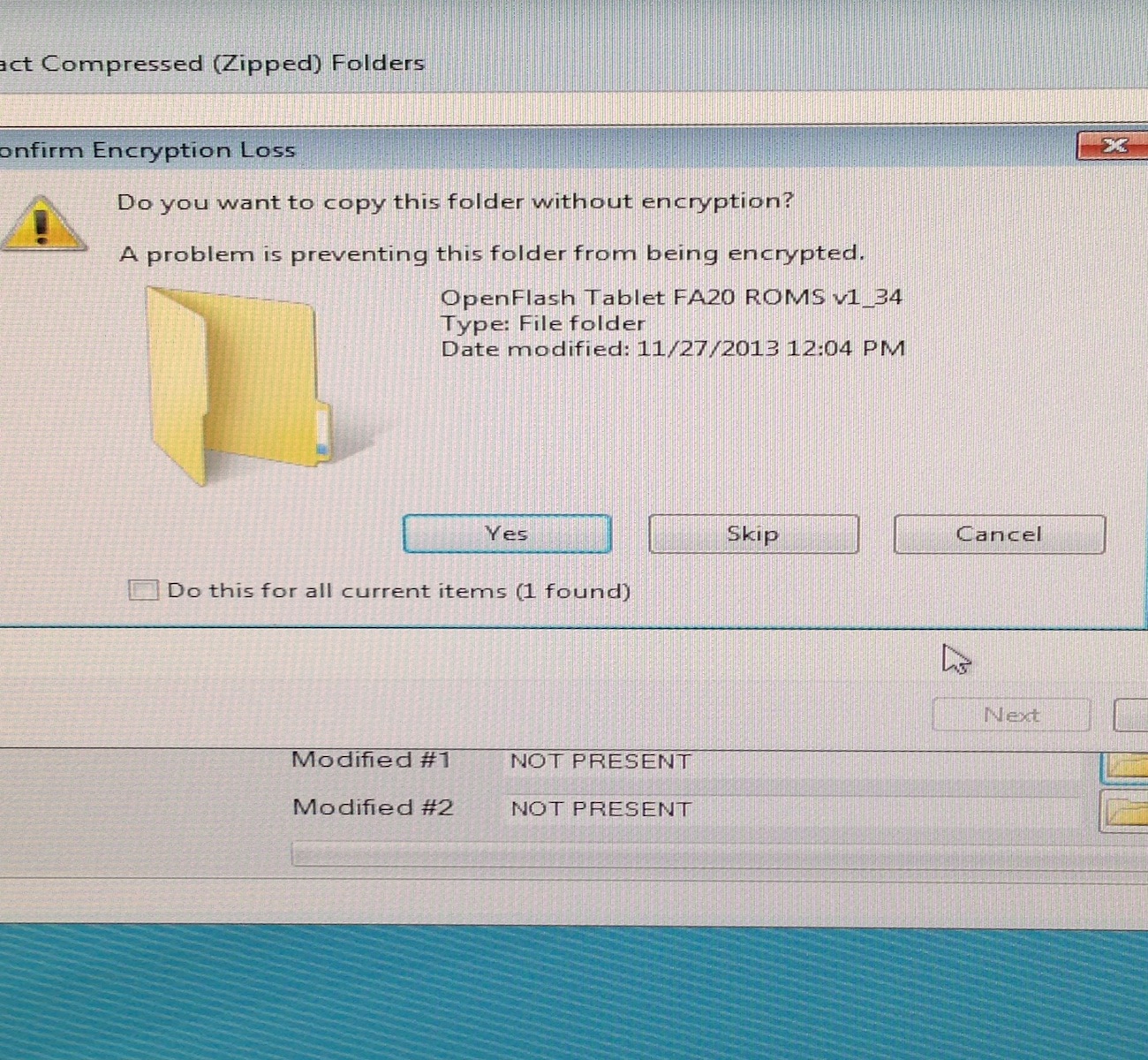

whats wrong
hello just received my OFT plugged into car everything is good. plug into computer everything is good my CAL is ZA1JB00C. I go to extract the downloaded zip file and get thisName:  IMG_1125.jpg
Size:  635.2 KB any ideas?

Just hit yes.

i did and i get thisName:  IMG_1129.jpg
then thisName:  IMG_1127.jpg
then thisName:  IMG_1128.jpg
i don't see my CAL id
Liquid6 is offline   Reply With Quote

its nothing like the web page video to upload maps idk its got to be something stupid I'm doing wrong. thanks for any help

did you check the other folders that are in that main folder for your cal ID?

I've only seen mention of that ZA1JB00C a couple times before. @Danklvr mentioned it to Shiv back on Nov. 18th and said he was going to email him the ROM as it appears to be new.

That's all there is I checked.

My car is new so maybe that's why. I have different CAL. Idk.

hello just received my OFT plugged into car everything is good. plug into computer everything is good my CAL is ZA1JB00C. I go to extract the downloaded zip file and get thisAttachment 59608 any ideas?
We don't have OTS maps for the ZA1JB00C ready just yet. We just saw this ROM for the first time a couple weeks ago. Hope to have them released this week though. Sorry for the delay....

For cal ID za1jb00c / za1jb01c just pm Shiv and let him know you need the tune file for this rom, advise on your current mods and he will send you the tuned file.
hes waiting to put it with the other tune files because i havent sent him any data logs yet - my vehicle in dealership for a repair.
also, new updated cal id Za1jb01C just released last week to fix idle issues.. if you have this version, send him the stock rom file for his review, and also send the rom to the guys @ romraider...
