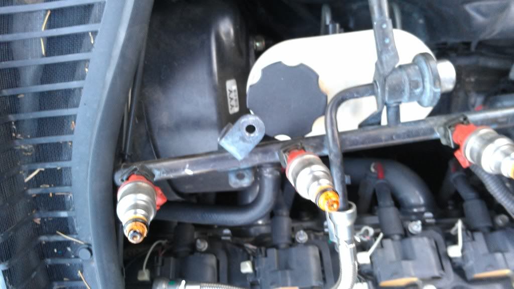

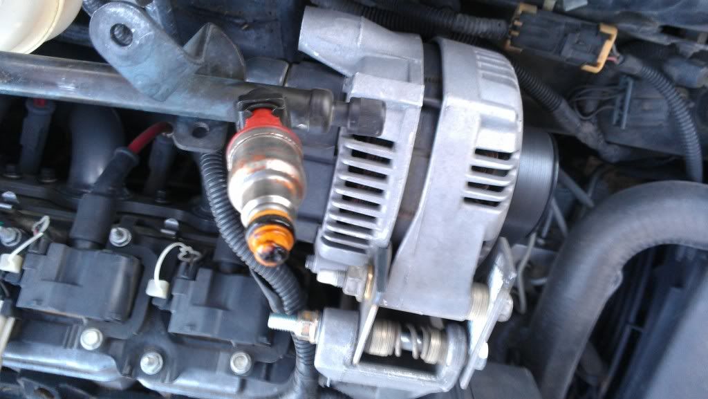

There are also a few other things to consider on E85. The idea of it eating fuel lines is actually more of a confusion with Methanol but Nelsmar is correct Ethanol will attract moisture.
However something else you should pay attention to is the fact that E85 also seems to have some issues over time with Injector build up and last I checked they were not exactly sure what was causing it. I have it even on my Vette and its been talked about on many forums, here are some from the Evo side of the house:
http://forums.evolutionm.net/e85-eth...nk-e-85-a.html
http://forums.evolutionm.net/e85-eth...k-seafoam.html
Its been awhile since I looked but I found just running a tank of gas cleared the issue or cleaning them manually which was not hard for me either. However the Gunk would get to the point it was really bad as you can see from some of their pictures.
Here are a few from mine over the last few years running E85:
This is not meant to scare you, E85 is something I run in my FR-S now and will always run in my Vette. Its a great fuel but it does have some concerns you need to address and this is one of them especially if you boost it.
However N/A and FI E85 can do wonders if you do things correctly. Keep things clean and find a solution that works for you in regards to cleaning. Even if its just running a tank of gas every so often (Easier for the N/A Guys I know) or a good cleaner if Seafoam works.
Just thought this was worth sharing as well. I personally love E85 as is apparent from it being used in both my vehicles. But as with any performance modification there are little things to be aware of. However the grin it will give you and the extra boost is always worth it in my opinion. (Not to mention the cooling effects, high octane rating etc)
