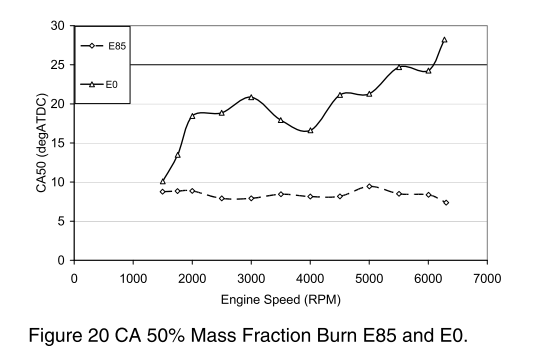

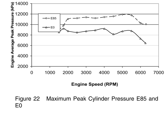

Here are some charts from an experimental GM LNF engine (found in Pontiac Solstice GXP) showing peak cylinder pressure on E85 vs E0, running at MBT (50% burn between 6 and 9 degrees ATDC) on E85 and whatever combustion phasing was needed at borderline knock condition on E0.
But you'll never know what your combustion phasing, burn delay, combustion speed, or peak pressure is without a combustion analysis system. And without that info, it will be difficult to make a link between spark timing, peak cylinder pressure, and the bearing durability question. You need a cylinder pressure sensor installed, and then you need to run different spark timing under WOT pulls and see how that affects peak pressure with E85 or race fuel. That's going to cost money--a lot more than a set of aftermarket bearings.
Unfortunately it still comes back to trial and error... run a certain setup, see if it breaks, and speculate as to why it broke and what needs to be changed to prevent it from breaking again.

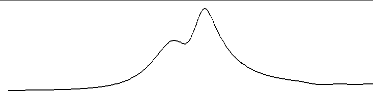

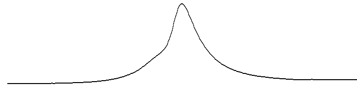

Well I'd have to see the exact text here. NA engines simply can't get more than maybe 16-17 bar IMEP (work before pumping and friction is subtracted). Boost can do a lot more than that, but has knock issues on pump gas so how do you compare? The same relationship I described earlier still exists. If the combustion is significantly retarded for knock relief, the peak pressure will be lower and display the "double hump" characteristic shown here:
while an MBT pressure trace at the same given torque looks more like this:
