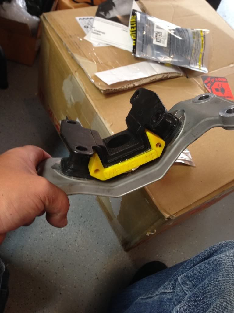

I removed the Perrin T tranny mount and installed the whiteline positive shift kit. Now with some time on that I can say that was a good decision overall. Still have better shifting without the whine noise. Many like that but it wasn't for me.
Here is whitelines in place. Installed stock T piece back in as well of course.

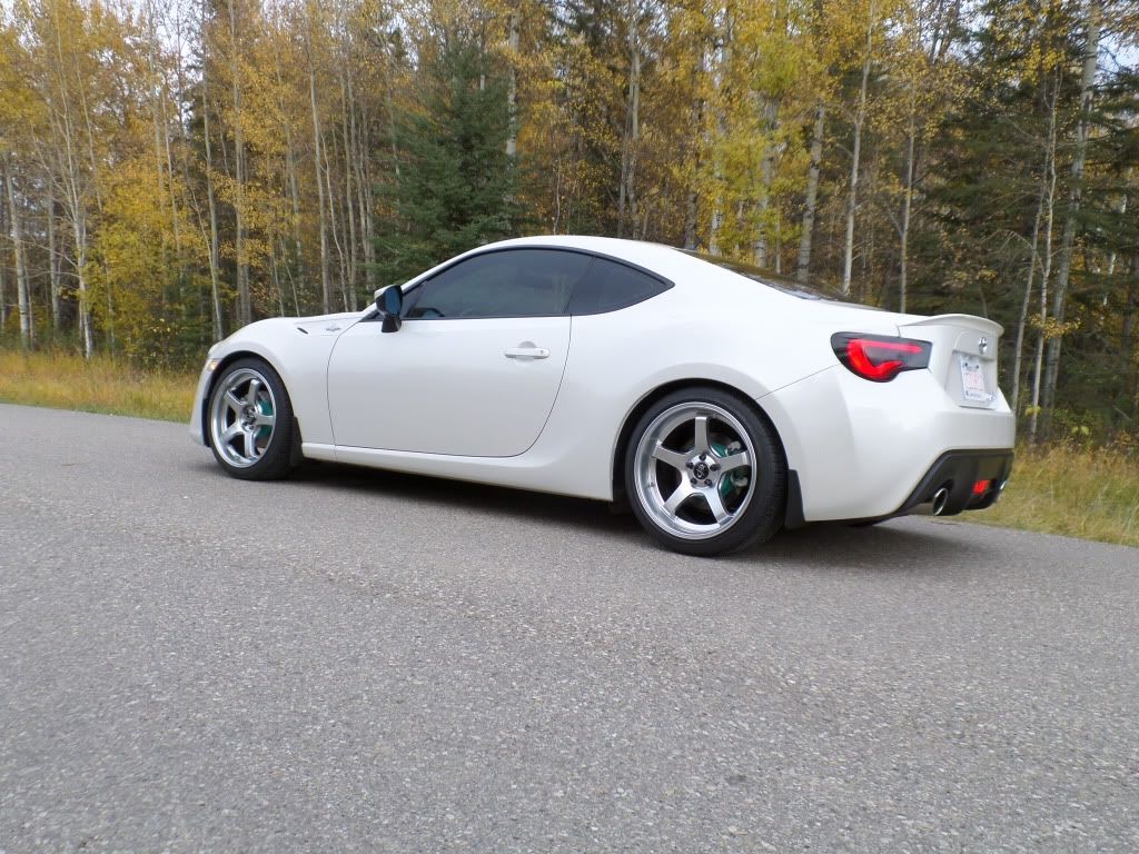

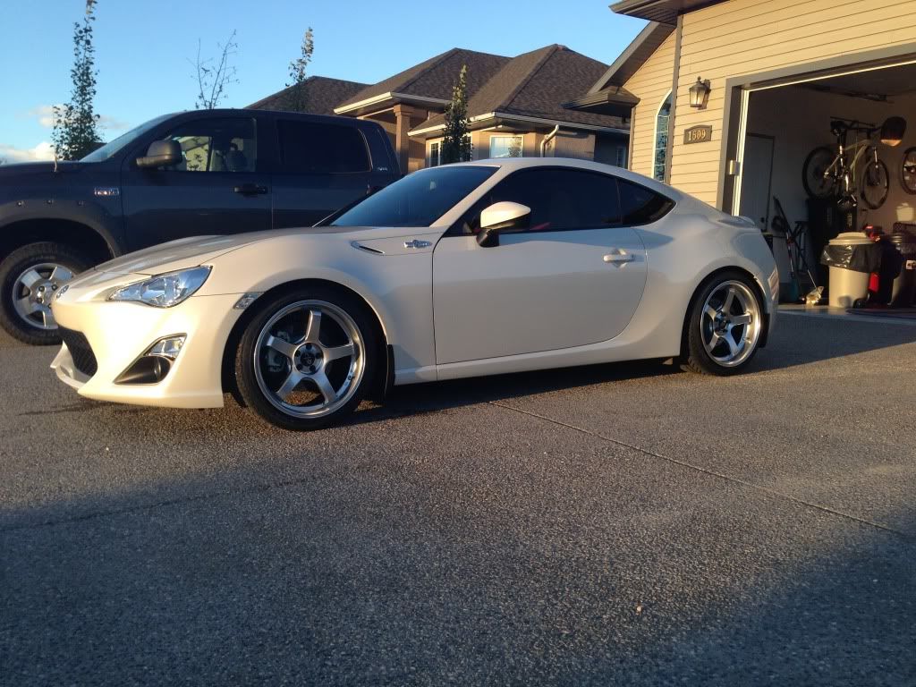

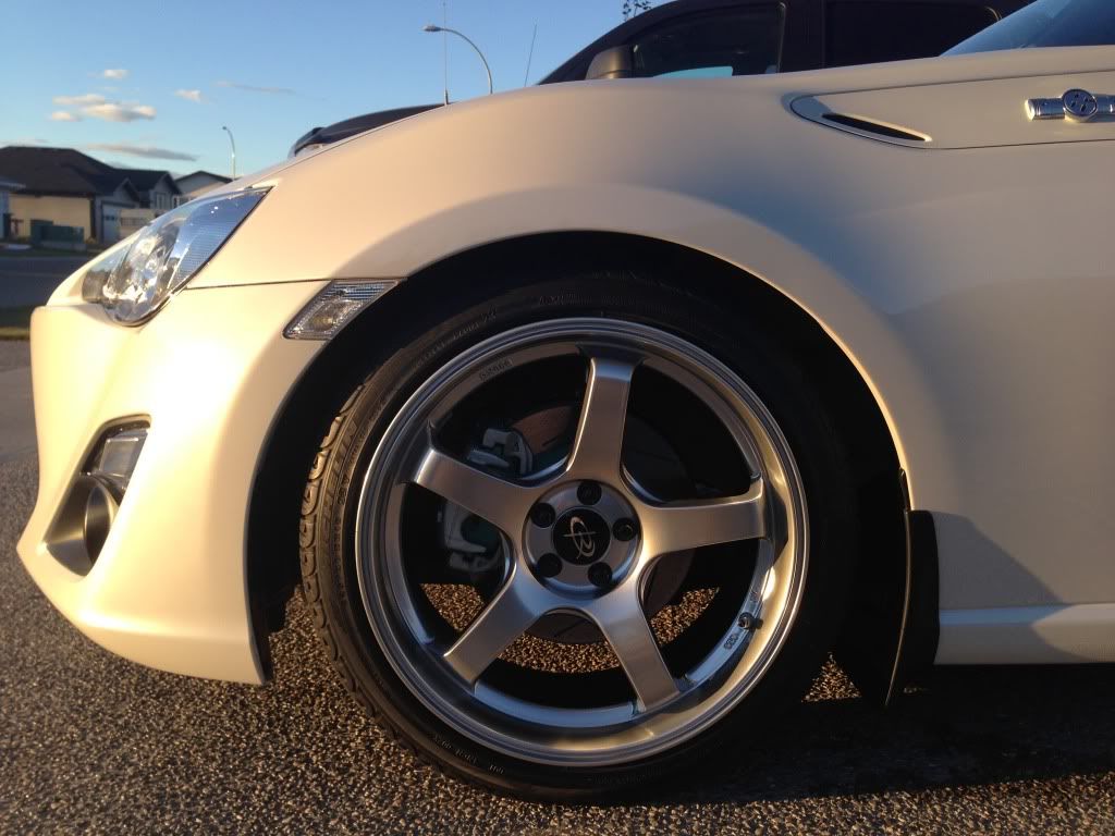

Not 100% certain on height yet may raise a touch but no bottoming out and ride is fantastic very pleased overall.
Current alignment is -2 all way around and zero toe. Looks funny in front now cause will be installing new wheels this winter so that will be ok for now.
Here's some pics

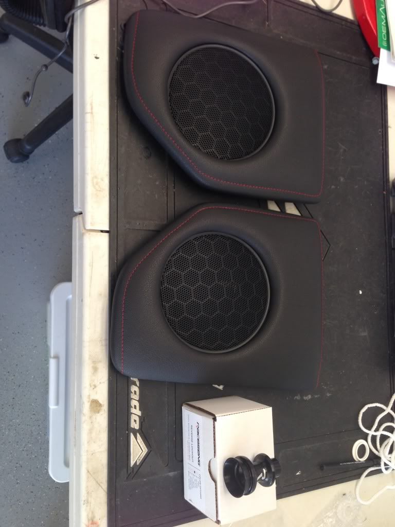

Raceseng Black reverse lockout, shout out to @Raceseng for quick delivery and quality again as always!
"IF" you purchase one of these, please note you would be best if you had someone to lend you a hand, if only to hold the wire carrier below the boot to keep the hole within reach for you to insert Racesengs bolt into the reverse lockout. Also a 3/32 punch and small hammer (IS) needed 100% to push out the roll pin from stock RL.

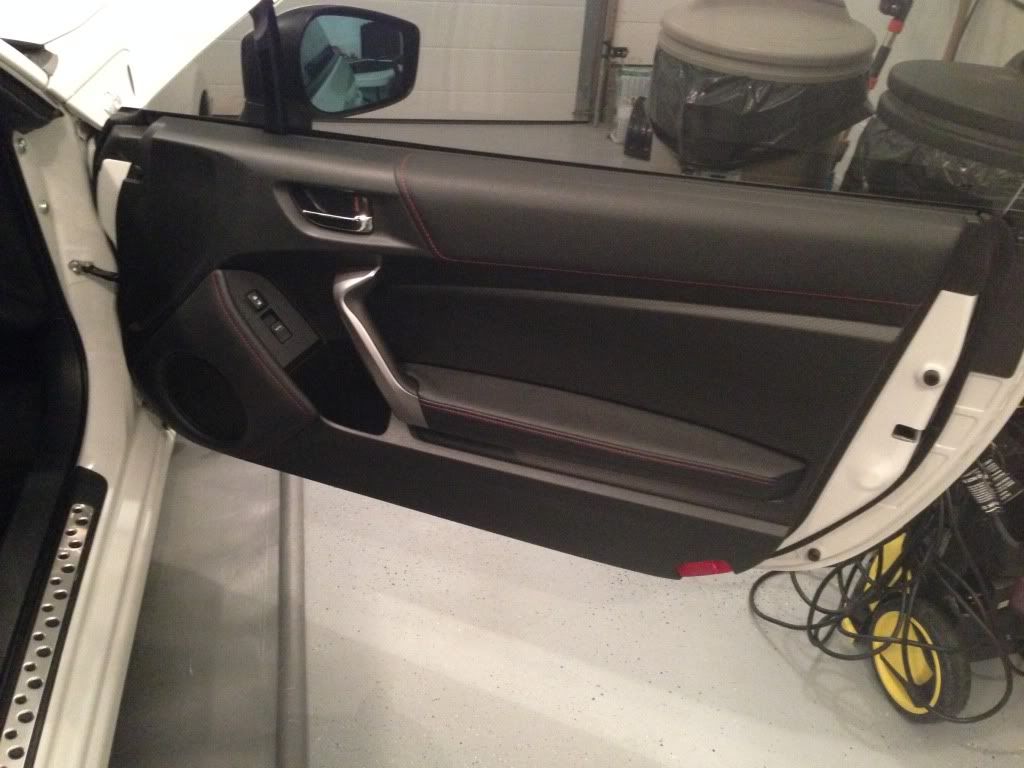

Next got in rest of my JPM Coachworks bits to complete my interior "for now" Again nothing but good craftsman ship from @JPM Coachworks again, thanks!

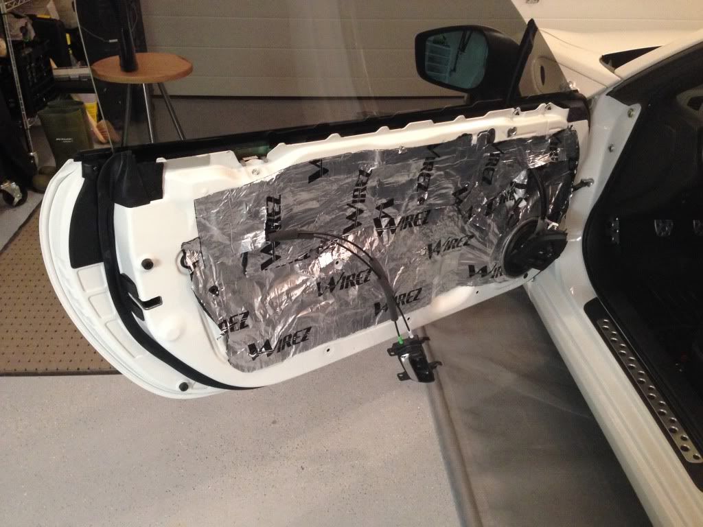

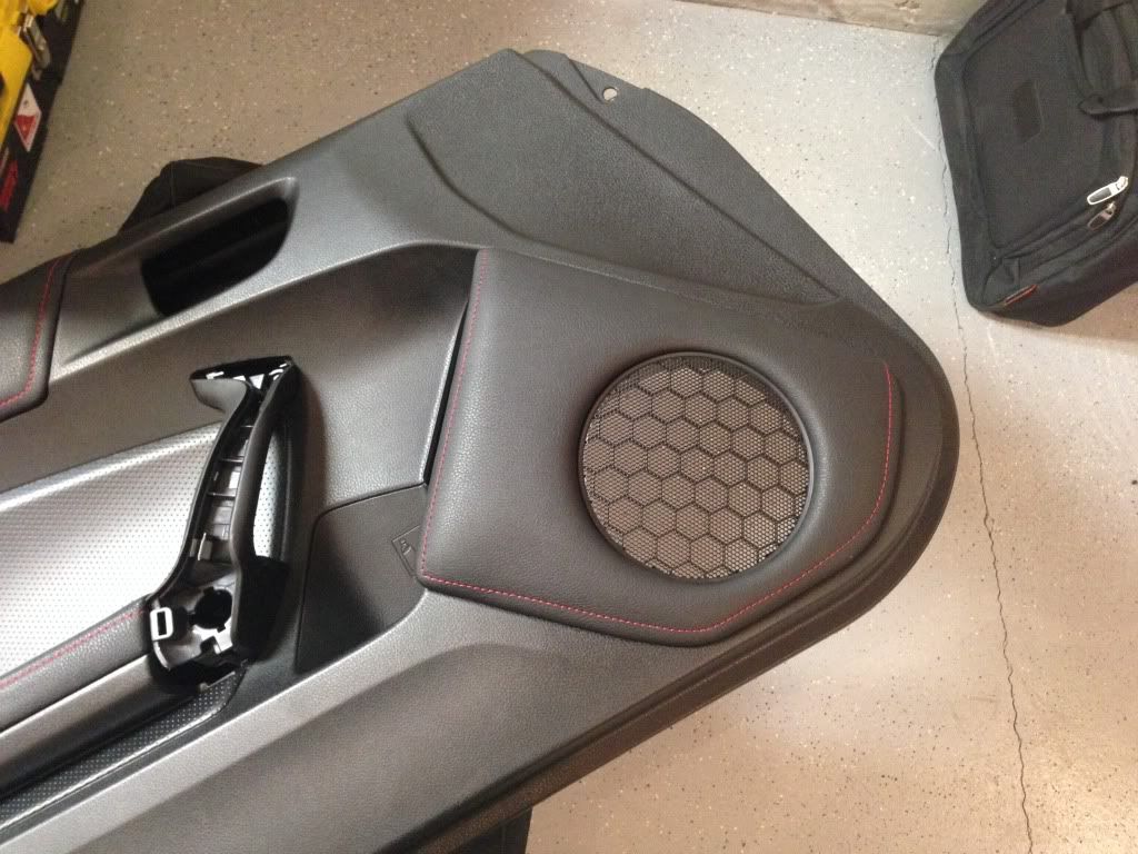

The leather and red stitched door panels to match all my existing JPM goodies. Took advantage of the task and also put on some more MLV and matting to doors for better sound isolation as well. To me this is how the car should come, looks soooooo much more complete IMO and adds luxury look and feel to the car. $ well worth spent IMO!
Left on
Right on

Yes karcher washer can't recall model # at moment, without any mud for a small car like this it works great. I wouldn't count on it for any heavy duty tasks though just for dust and mild dirt. Was around a few hundred bucks is all so for that I am pleased.
Doing MLV and cascade matting in the car was the best thing I ever did, the reduction of noise from road noise/exhaust was dramatic to say the very least. I also have done my entire trunk, back top deck and trunk as well, sure it adds some weight but my doors close solid, the improvement in sound quality from my stereo and exterior noise reduction is 100% worth it imo.
