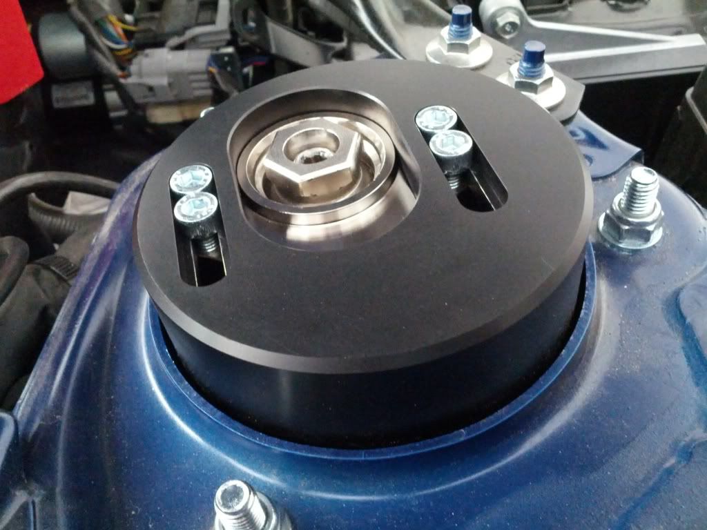

Well, I've been lurking on this thread with the replacement com-c's on the car without too many problems, however the last few days I've noticed a large clunking sound while driving coming from the front. Debating about going back to the stockers, but I'm wondering if someone here can offer up a alternate solution - I have the stock structs with RCE yellows on the car, so I need a top hat that could adjust camber/caster with that setup. @neurokinetik - do you know if the GC caster/camber plates will work? I seem to recall another thead stating they only were for use with aftermarket coilovers. Thanks for the info/advice in advance!
I'm running HVT plates with RCE yellow springs and stock struts. Although the caster isn't adjustable they do have additional built in. The are quiet and allow 2 degrees of negative camber on this setup. I've been very pleased with them.
Hello,
I don't think the GC plates work with anything other than coilovers.
I would recommend the HVT plates fstlane posted above. Quiet, functional, and non-raising.
You have to specify your spring diameter with the GC plates when you order them. The only options I see right now are 2", 2.5" and 60mm. Pretty sure stock spring sizes are way bigger than all of those.
Yup - GC answered me pretty quick - they are no designed for the OEM strut. After looking around I ended up putting a order in for the HVT's - looks like they get a good review, just really expensive! I'm just ready to get away from the Com-Cs - liked the 2 degrees they gave you out of the box, but just not a quality product. Surprised actually to see a lot of the stores that advertise here still have them listed, FT86SpeedFactory/RCE to name two of them I saw today poking around.

Just thought i would share the short email conversation i had with whiteline's tech department here in Aus:
Subject: RE: 86/BRZ Com-C
Hi Marcus,
We are discussing but no ETA at present.
Regards
John Leighton
Tech support
Hi John,
Thanks for the reply. Are you developing a 86 specific version?
Regards
Marcus Galagher
Hi Marcus,
We do offer part number KCA335 (for Impreza), that will bolt on, but there are 2 issues –
The caster angle once installed, on the 86 loads the bearing up quite allot
And the studs are not long enough for our 86 strut brace to bolt on
Regards
John Leighton
Tech support
Subject: 86/BRZ Com-C
Hi,
I was just wondering if there was an ETA on the com-c strut tops for the Toyota 86? I am looking at buying some coilovers in the next month and was hoping to use the com-c at the same time.
Regards
Marcus Galagher
Sorry its in email order, i am too lazy to rearrange it to chronological. But i would say if you have noisy ones already push for a refund.
