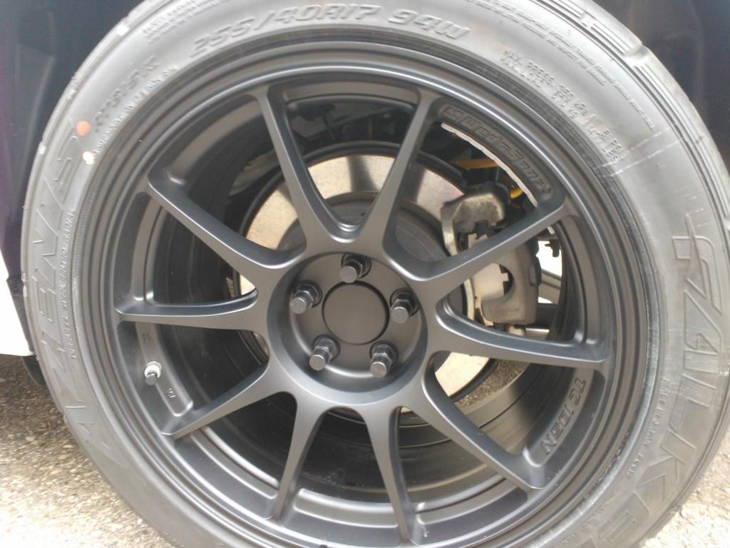

Curious to ask, are there any center caps even available for these wheels? I think answer is no, I haven't seen them but thought to ask anyhow just in case.

There are the wedssport ones. I was making a center cap/hubcentric ring for awhile but unfortunately I don't have any left. I could get you a drawing though if you want to have them made somewhere.

I have the Wedsport center caps for mine. They look pretty great IMHO.

I love the blacked out look

Weds makes a set, pretty pricey for what they are though, and you can only use them or hubcentric spacers, not both at the same time.
Alternatively, @kask2_6.0 fabricated the aluminum ones that serve both purposes. That's what I went with. Also pricey, but dual-function.
Speaking of the aluminum ones, I ended up scratching the paint off of one of mine when I was switching to my winter wheels. I didn't realize the cap was still on the hub and ended up scuffing the edges. Anyone know of a good way to touch that up or is it best to just get it anodized all over again?

Using some hobby paint and a tiny brush will probably be your best bet. Not sure what the process is for re anodizing a part.
