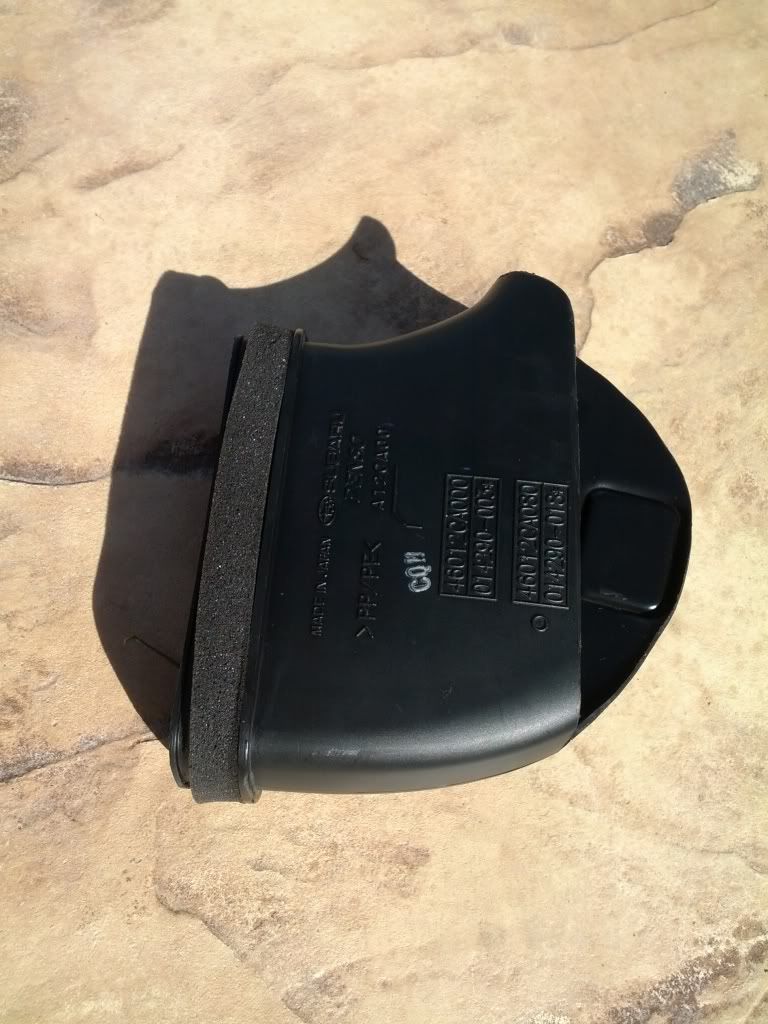

Originally Posted by fstlane View Post
I love the combination of uel headers + snorkel delete. It sounds perfect! But I still wasn't too keen about the airbox intake exposed to the hot engine bay so I chopped it up.
I trimmed it so it extends just out of the engine bay but still near its widest point.
Looks good! I finally got around to modifying mine today, thanks to my handy dremel
Nice work!
