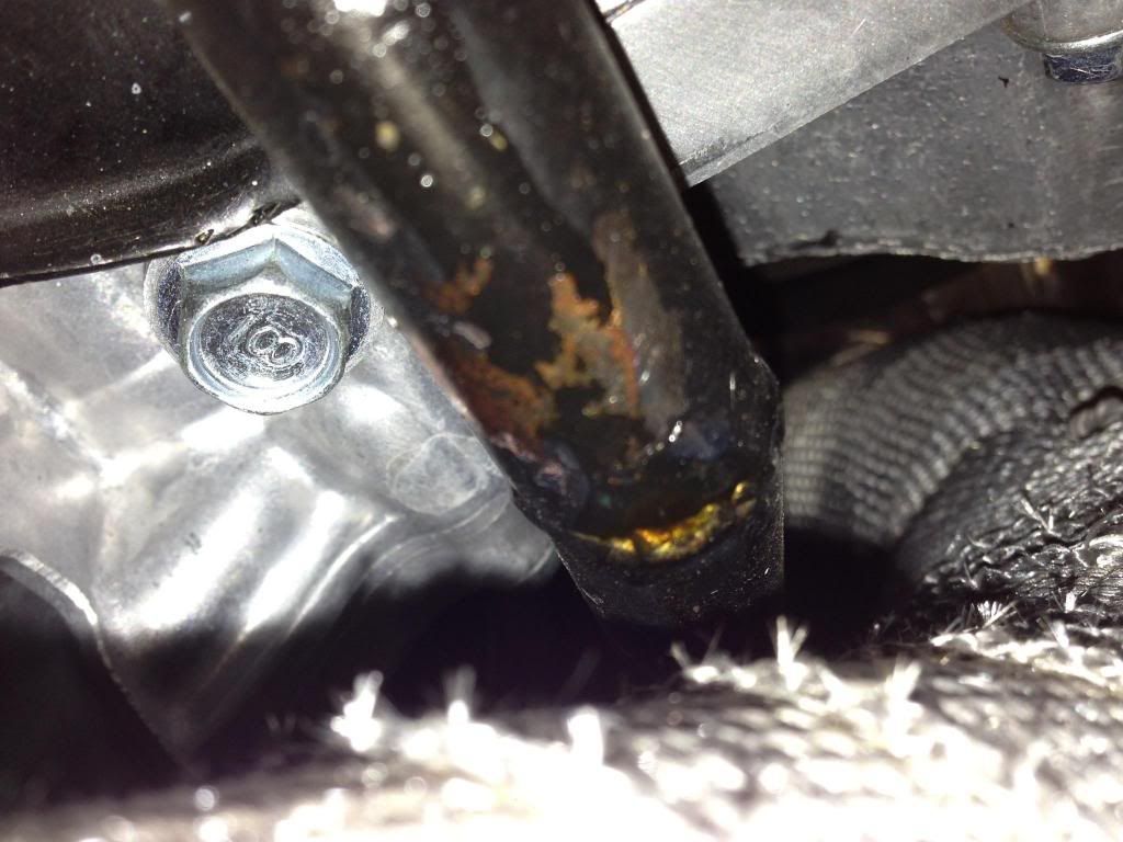

It happened because no heat protective wrap. Where the heck is the provided thremal wrap that is supposed to be safety wired to those hoses? Mine came with it, but I will have to check my coolant lines now after seeing this.
My kit came with no thermal wrap of any kind. Not sure if it depends on the kit you buy.
Keep an eye on the oil pan bung. Mine developed a slow leak on one of the welds on the bung itself, and it's not a great place for it to do so.

So neither of your water cooling hoses for the turbo have any heat protection and are just rubber hoses? I would use a little JB Stick on that if you don't want to pull it to have it fixed. I will have to check mine as well.
neither of my coolant hoses that go to the turbo have heat protection either
