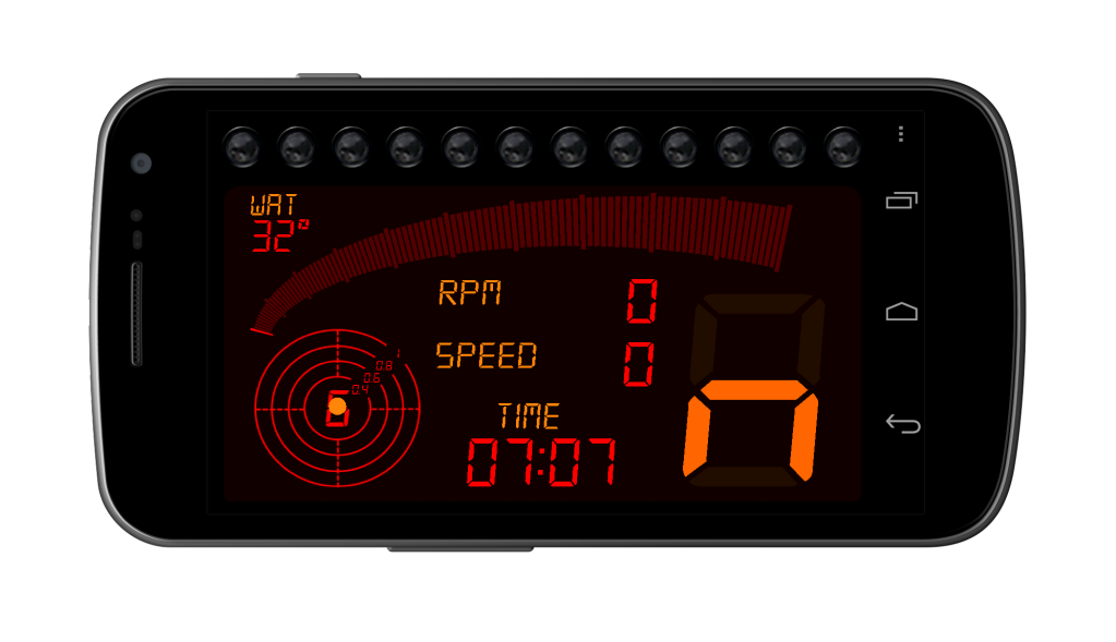

Now that someone started it I'll go with it so consider this a friendly thread jacking haha. What's the suggested obd2 scanner for torque app on Android. I use a galaxy nexus and I just don't understand why there is so much cost variance. I want a basic scanner for engine temps tach and mph. Nothing crazy I have only bolt ons for performance. Shud I just get the 10$ one mentioned above? The scanner plugs into the USB port under the climate control buttons right? Thanks a lot!
Sent from my Galaxy Nexus using Tapatalk 4
The $10 eBay ELM327 mini Bluetooth OBD2 scanner is what I use with my Galaxy Nexus and it works fine. There are a lot of nice plugins available for the TorquePro app to do what you are wanting. Here's one I was messing around with earlier.
