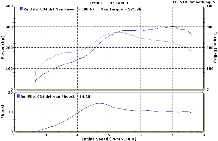

Took some time to get back to you all; it's been a really busy week. For right now I have my Dyno chart to post up. Let me know what you think. She feels like a rocket when the 1000cc IDs kick in at 5K RPM

Very interesting. That small turbo didn't spool as quickly as I thought it would, but that 14 psi hit gave you a real nice torque peak, unfortunately it starts tailing off immediately and you drop to 10 psi by redline. Still I am very impressed with the kit and I bet it does feel amazing at 5000 RPM.
