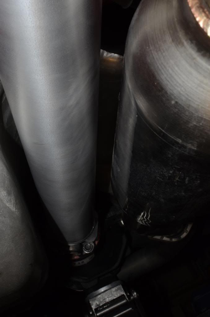

Clearance issues? None. I have the Ark Helmholtz resonated front pipe and Invidia N1 catback. No issues with them what-so-ever. There is a pic of the closest that this driveshaft comes to MY exhaust. You can easily fit a finger or thumb in there.

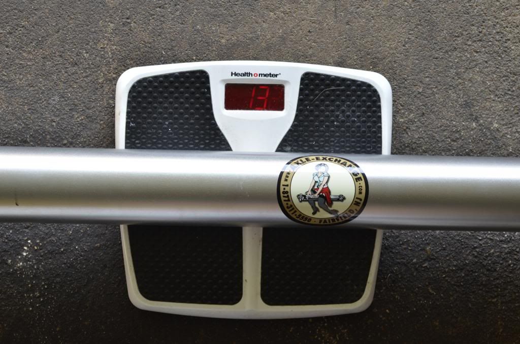

Mine weighs 13.2 lbs on my bathroom scale. So give or take a pound...

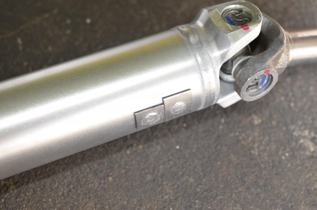

Yup, it's been balanced. They say they balance them to 5000 rpms. I had 3 weights on mine.

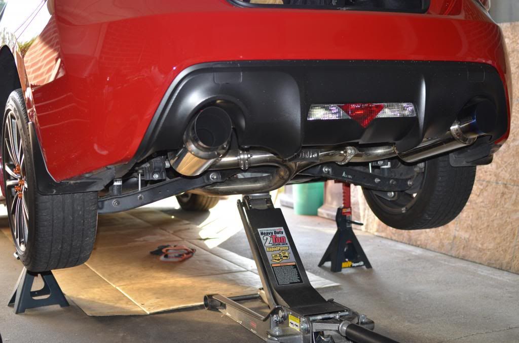

Ahhhhh man, my car got jacked up!!

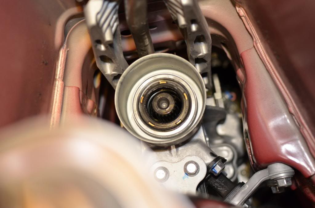

Here is the front. You can clearly see the delicate seal. Hmmm I wonder if we make these in my factory?

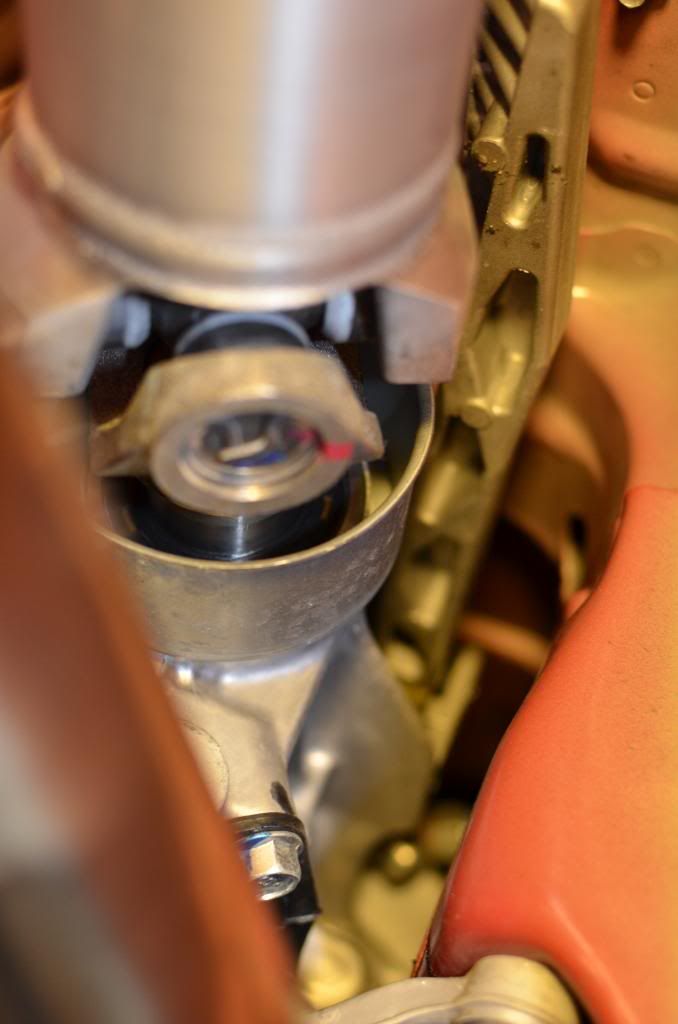

Front installed. Very hard pic to take but it's a nice fit in there with the seal.

Finger clearance with the closest part of the exhaust. This happened to be my N1 resonator.
Another shot of clearance.

I do notice a little noise/vib from 5000 rpms and higher.
It shouldn't vibrate. Clock it 90 degrees and try again. One of the four positions should ideally have no vibration.
Originally Posted by JimmyMac View Post
I did notice that free reving is a little quicker and it no longer has that rev hang as before.
Free-revving with the clutch depressed doesn't spin the driveshaft at all. The engine is on its own. Rev hang is solved with a lighter flywheel.
Good point, I wonder how I was doing it then. I'll have to review that.
Today I'll go out again and check for any vibes. If need be I can rotate it. That's why I marked it. Then it'll be the fun part of pulling the hand brake, lay under the car, loosen the bolt, release brake, rotate shaft, pull brake, etc., etc.. Hehe
