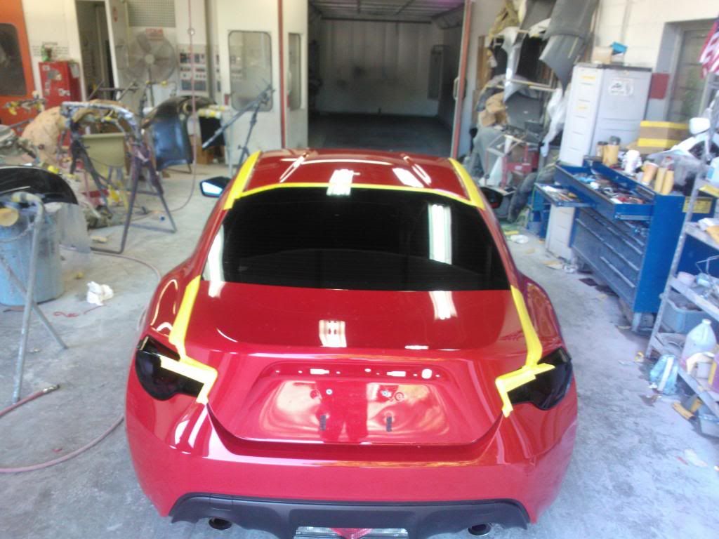

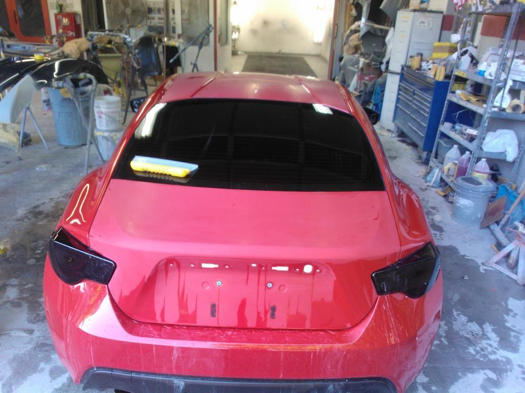

Initial mask-off to prevent damage to surrounding panels. All mouldings/antenna removed.
Prepped, washed... ready for booth.

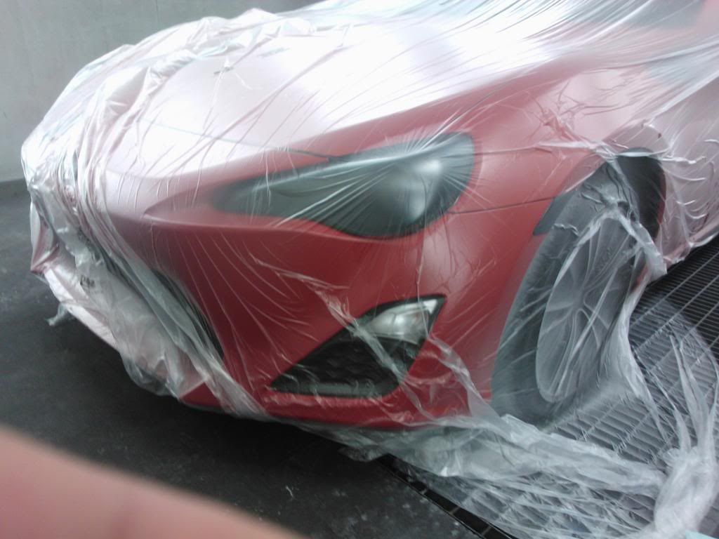

In the booth, time to dry off the car as much as possible.

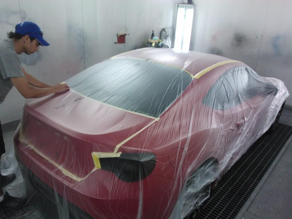

Covered up!
Please cut on dotted lines:
Wax & Grease remover on all painted surfaces. Tack cloth to dry.

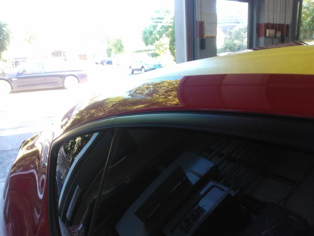

So... do you have a clue yet ?

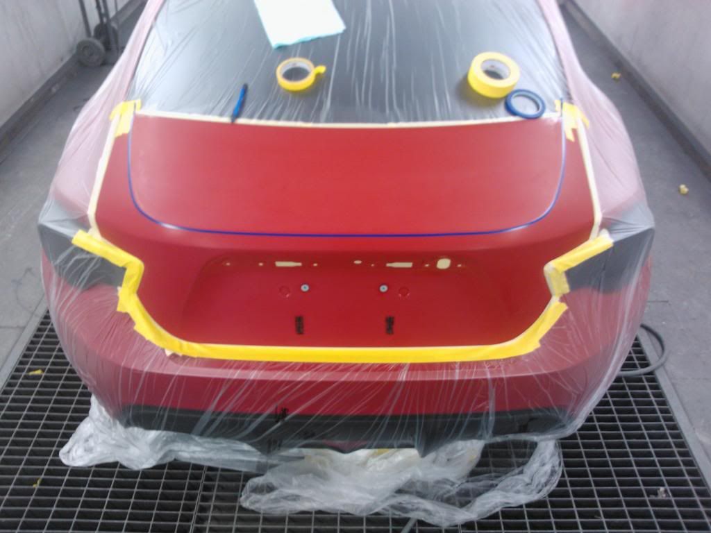

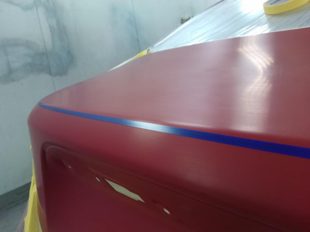

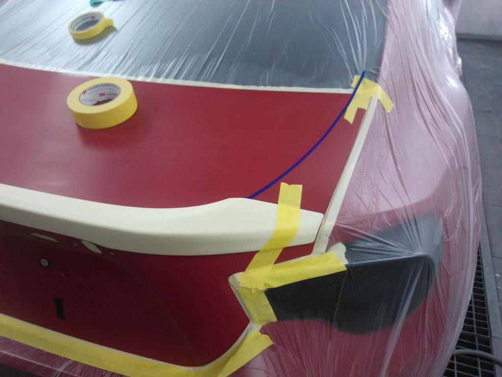

The top is going to be black. Here is a better look a the line. It is DEAD center of the curve. Very tough line to follow.

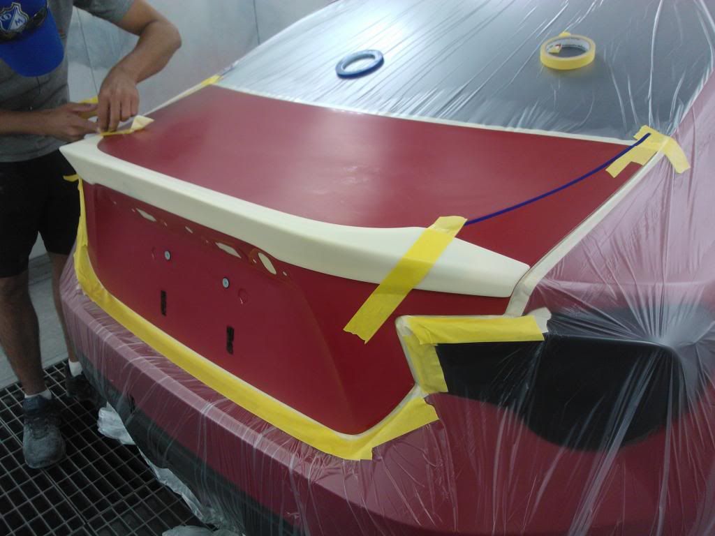

Test fitting the spoiler....
...and it's no good Does not flow with spoiler. So...

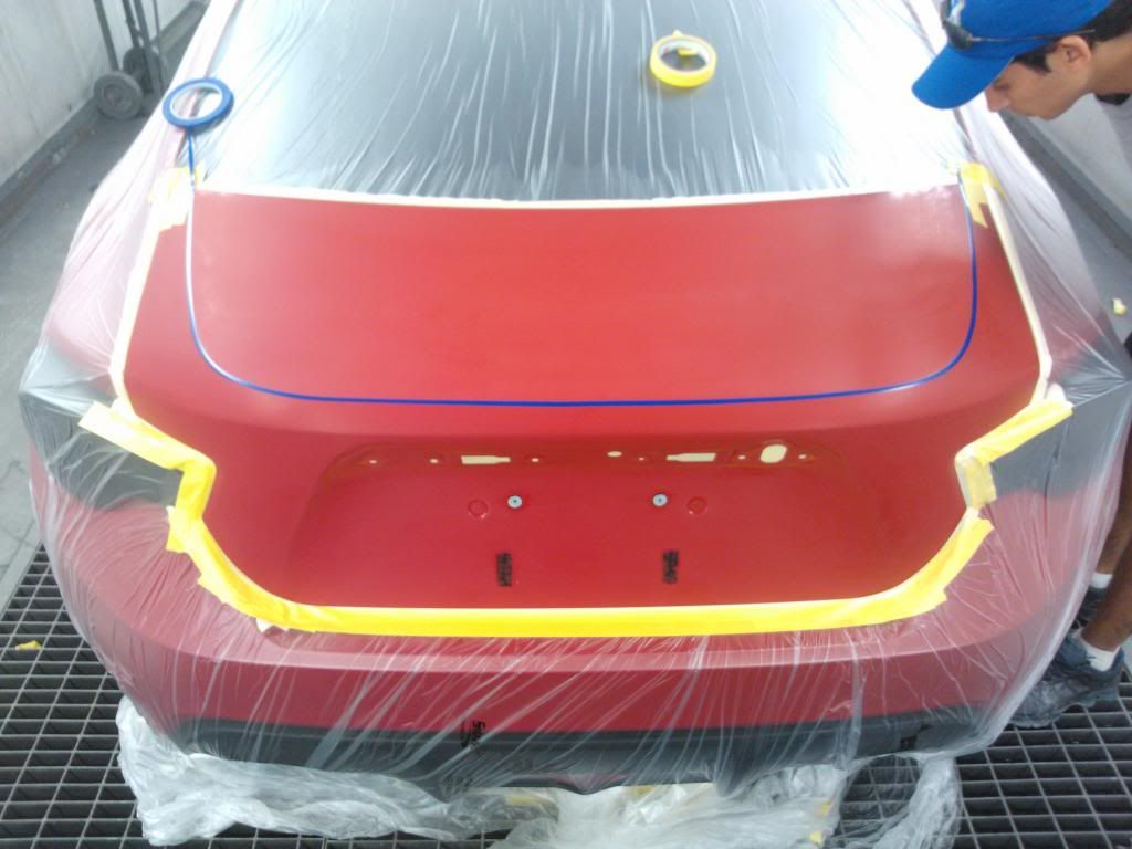

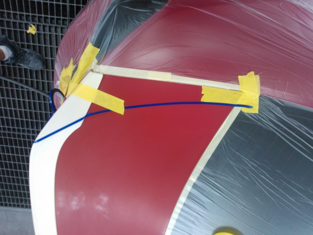

The top black panel was widened ever so slightly, to expand a bit over the curve:
This time around, it follows the lines of the spoiler much better
Acceptable. Very acceptable. (You can't see what I could. Sorry for crappy cell pics!)
It's a done deal...

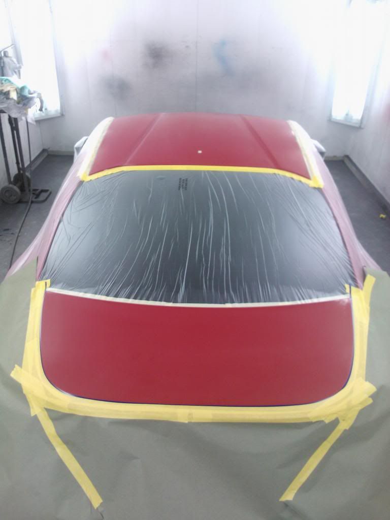

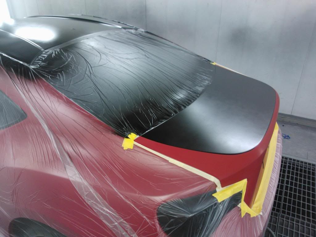

Time to mask off anything we don't want black:

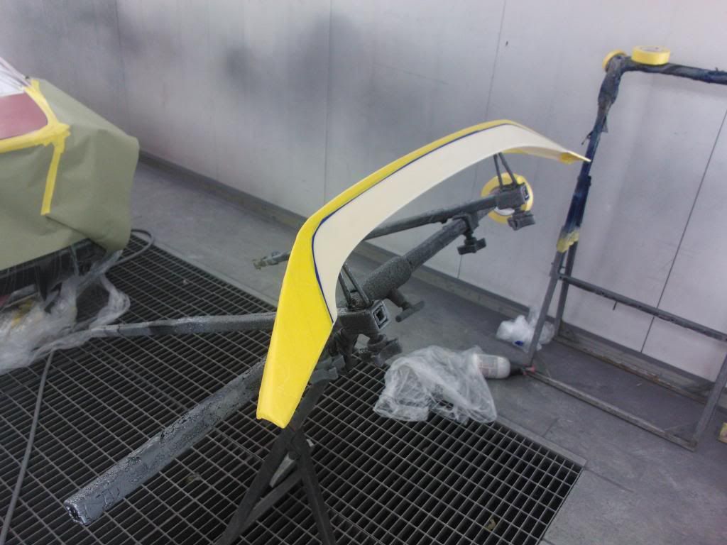

Don't forget the spoiler! (We shot the black first on it):

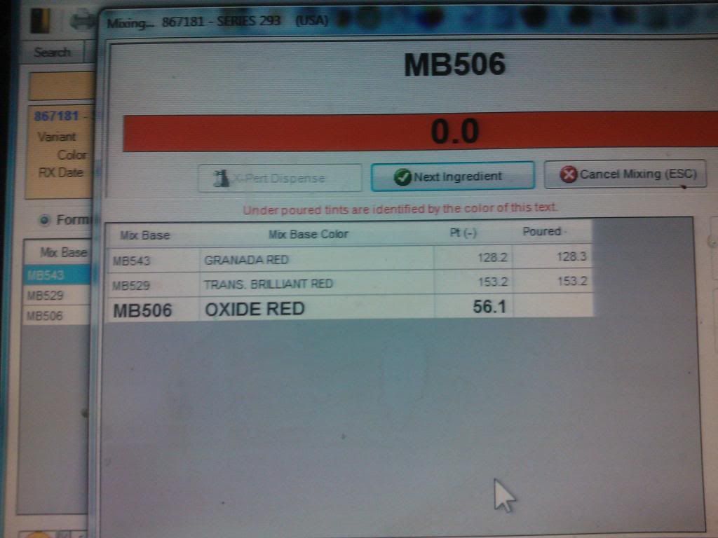

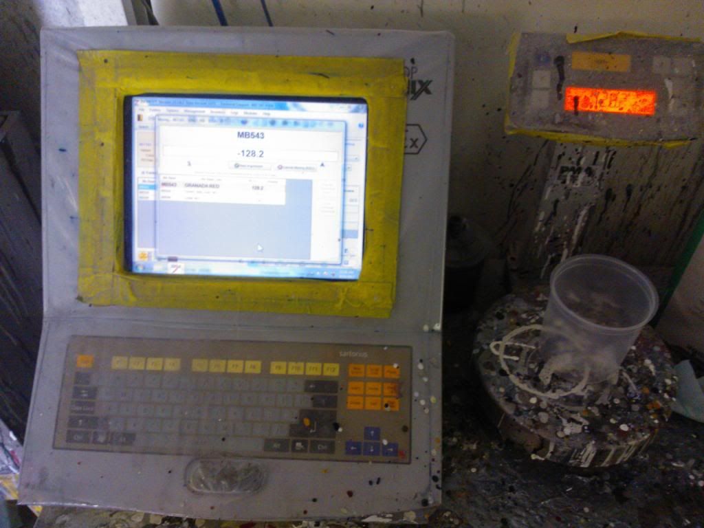

Time to mix some paint....
DAMNIT! I WENT OVER BY .1 GRAMS! ....I forgot to "correct & recalculate" It'll be alright though

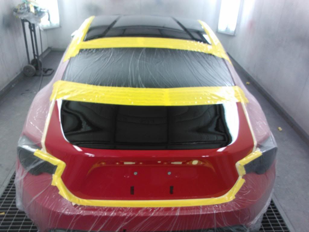

First coat of black (spoiler not shown):
Black dried... taped off spoiler on opposite side, and painted it red:

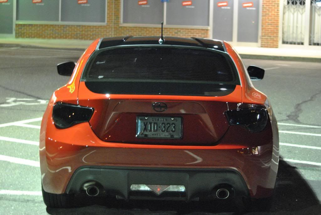

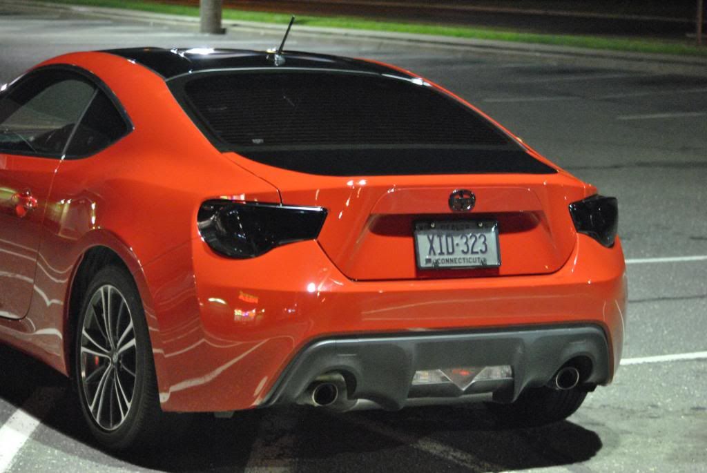

I put everything together.
Did not buff anything, did not clean off any fingerprints, did not take off overspray.... so please pay no mind to that!
Here's some night shots, sans spoiler:
Dat ass. I think it looks damn good even without the spoiler.
The light just melts over the trunk. (In this pic, you can see the rough edges on the trunk though, hehe)
A bit further back.
Not the best pic, but just trying to show the luster. (I was standing almost 40ft away.... big lens :X, could't find stock lens for camera)
