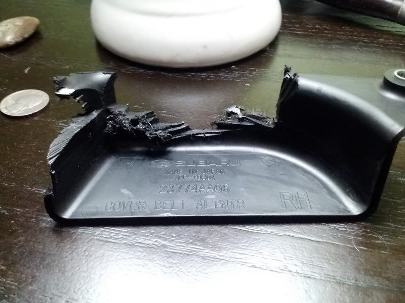

okay, so i'm trying to figure out what i'm doing wrong that could cause the supercharger to eat a belt, then cause this:
that's the belt cover for the alternator. I don't know if it's because the belt isn't tight enough or what, but i'm going to check the tension when the motor has cooled off.
It's hard to tell 2nd hand and from a picture on the internet, but it looks like the belt wore through that from underneath. That makes me think there was too much slack.
I wonder if the idler after the alternator is binding up and causing the belt to "bunch up" around the alternator pulley.
Does your AC compressor clutch make an excessive noise when disengaged? Often times this is a pretty clear indicator of a failing auto tensioner. I actually had mine go when my car was complete stock with less than 10K on it. Also, ensure that your belt is in proper alignment, with no side loading at any point through the pulleys.
mines13 is offline   Reply With Quote
my friend is thinking that it might be possible that this blower needs a lower redline, I don't know what could be causing it to jump up and eat the plastic. uploading another pic
don't think they'd cover it under warranty though. how much would that cost to fix?
What is your redline? is it still 7400rpm?
yeah, stock redline.
that's what it did to the bottom of the belt cover

Did you file the alternator? I am thinking your blower might not be sitting squarely on the engine. If it is cocked just a little bit it will cause the belt to come off or be stressed unnecessarily.
we did file the alternator, it wouldn't sit right otherwise. and i'm curious as to why this would only happen now, when I've had the blower on there for almost a month. yesterday it ate the belt, and now this with the new belt. I've left a message with the parts dept at my local Toyota dealership to find out the cost of a new tensioner and alternator belt cover.
edit: just went out and checked, there IS some play in the belt.
