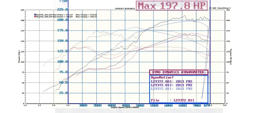

Originally Posted by Gary in NJ View Post
I took some time to compare Fenton's STOCK torque values with other dyno posts that were closer to sea level. This was a wide cross section of owners that installed headers, turbos and SC's. Sure enough, Fenton's stock torque is about 15% below what others are showing below 4000 rpm, and about 10% below what others are showing between 4000-6000 rpm and then about 12% below through 7000 rpm.
Plugging this info into spreadsheet it's easy to see that the eCharger should be able to produce a peak of ~205 lb-ft of torque @ 4750 rpm below 1,000' MSL. 90% of this value (~185 lb-ft) is available between 3000 and 6000 rpm. Peak horsepower (TQ x RPM / 5252) of 230 should occur at 6750 rpm.
What's most exciting about this (to me at least) is that this setup has a Clark Kent / Superman personality; mild mannered most of the time but able to leap tall buildings when required.
When can I buy this? Seriously, please take my money.
Comparing curves:
Name:  inn vs FTS.jpg

Originally Posted by Robftss View Post
Comparing curves:
Attachment 45725
That is the lower HP one as well not the tuned one
