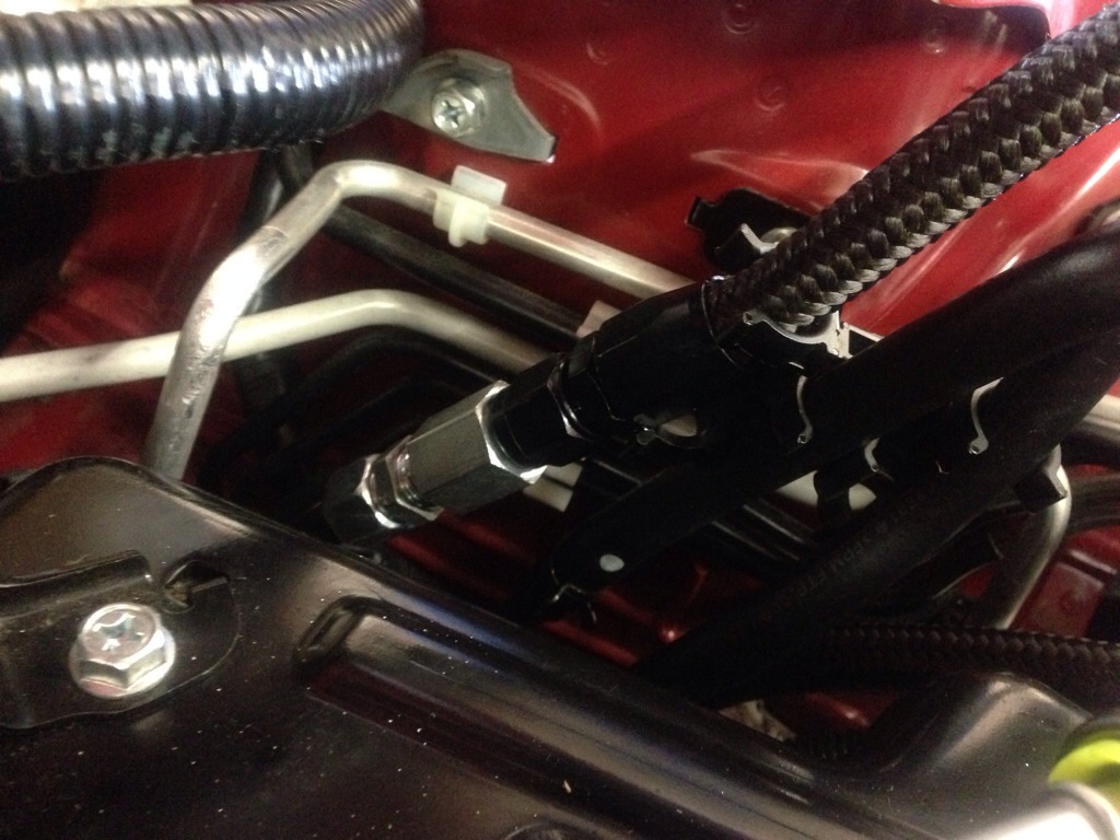

Here it is.. No more clamp
Attachment 45494
Sweet, the sooner the better
Sent from my SGH-M919 using Tapatalk 4 Beta
