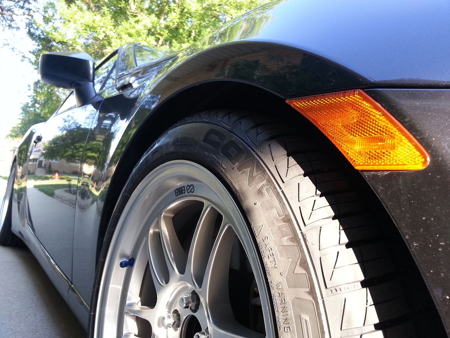

Just to add, I have sportline springs with 17x9 +45 RPF1s with 3mm spacers all around
No rubbing issues, tires clear the stock struts (barely), and no contact with anything (splash guards, tie rod ends) at full steering lock
Tires are 245 wide
I was thinking coilovers, but these springs are a very nice drop and I think almost perfect for a street drop with wheels. You are not "stanced" but you have a very functional drop with good asthetics
Tires are 245 wide
Tires are 245 wide
Man I'm very surprised you don't have any rubbing with the specs of your wheels. Mine are 18x9 +42, with 245/35/18 continental and they are damn close. Yours would be 3mm in, but I guess since you're running 17's that might be the difference. Do you have camber?
Stock Camber @ 1.4: drop, the rear looks to be about -1.5* and the front is maybe -.5*
Tires are Continental ExtremeContact DWS 245/40ZR-17
My specs with the spacers is +42 as well, where do you have rubbing issues? The only place I see that is close to rubbing is the tire -> bottom spring perch on the front struts
Ohhh sorry I missed the 3mm spacer note. In that case ignore my comment! You would be rubbing the spring perch without the spacer right?
