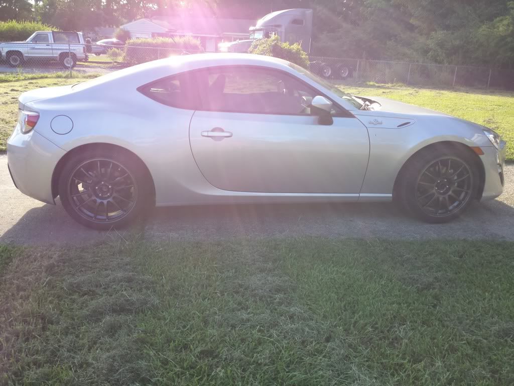

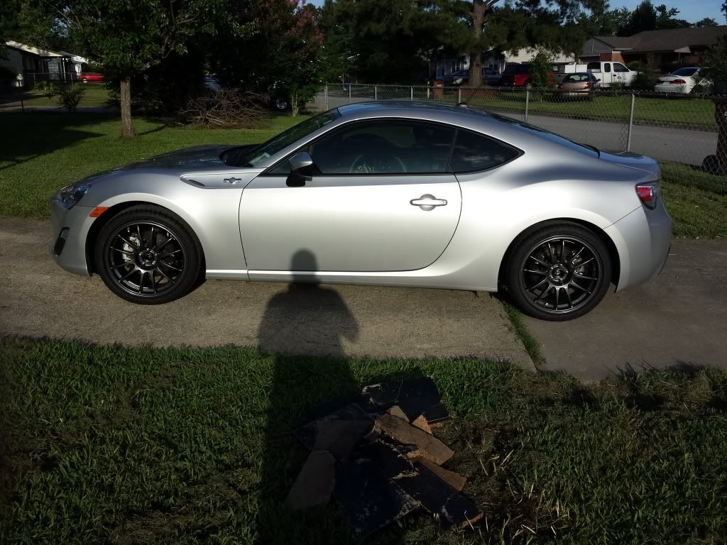

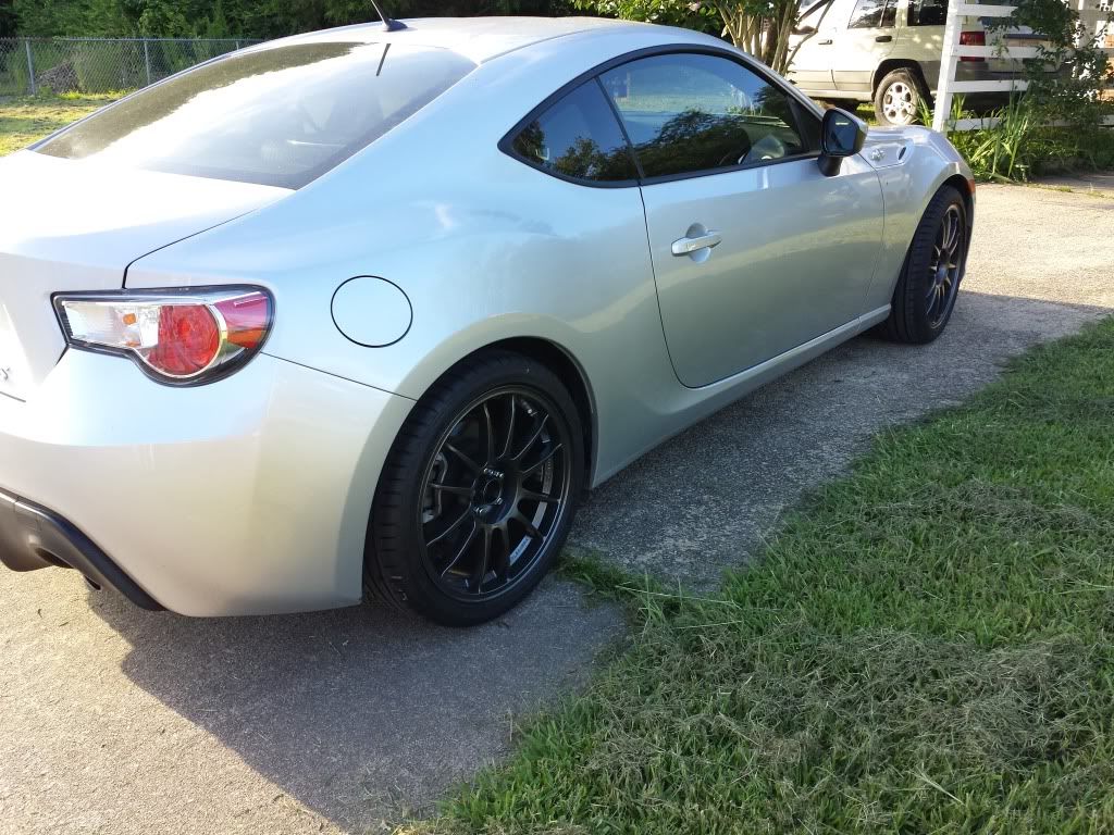

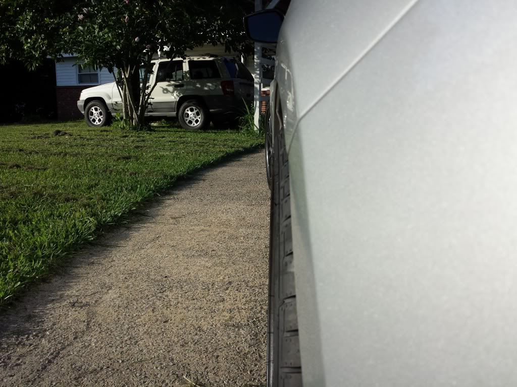

i just picked up a set of powdercoated 18x8 et35 oz racing superleggera rims. today i got them mounted and balanced on 245 35 18 dunlop tires just to get me started. now im a little worried to lower the car because i think it is too close to the out side of the fender... let me know what you guys think. imterested in the eibach sportlines just so you guys know what im planning

As soon as you lower it you will have enough camber where it won't matter

No you don't need coilovers for camber. As soon as you add springs depending on the drop you will have what people refer to now as "natural camber". Your wheels will tilt up top as soon as you change the suspension geometry.

The geometry of the suspension will cause the top of the tire to tilt inward as it's compressed through it's range (adds negative camber). It's typical, as the body leans in a fast turn, the added camber helps keep the contact patch more square instead of rolling onto the tire's shoulder. In other words, the wheel's path doesn't travel straight up and down, it's a slight inward arc.
I'm not a huge slammed suspension guru, but it doesn't seem like you'd have any real issues if you lowered moderately. The wheel will still follow the same arc when you hit a bump or dip. Worst case you might need to roll the fender. Personally I wouldn't slam it, maybe an inch or so, but that's preference.
