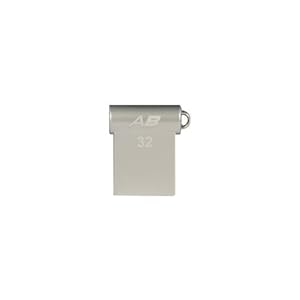

Now, I'm looking for the highest capacity flash drive that is mirco form factor so it doesn't stick out so much. I'd hate to bump into it while shifting and break it or worse, damage the USB port.

So small it's hard to remove.
[ame="http://www.amazon.com/computers-accessories/dp/B00AEGIPD4"]Amazon.com: Patriot Autobahn 32GB 2.0 USB Flash Drive (PSF32GLSABUSB): Computers & Accessories[/ame]
